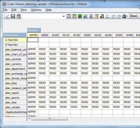

Actually Comma is correct, and I don't think that this is recent; I know that the behaviour is the same in 9.0. But just to illustrate on 9.5, I have two dimensions A Test Dim and B Test Dim assigned to A Test Cube
Initially neither one of them has any security access for any group:

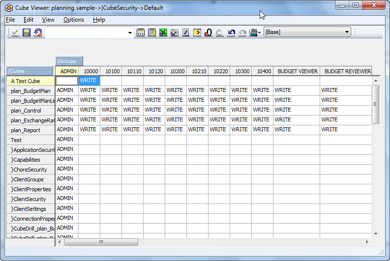

I assign Write security to the cube to group 10000 via the cube viewer:
02 Cube Security.jpg (172.99 KiB) Viewed 13573 times

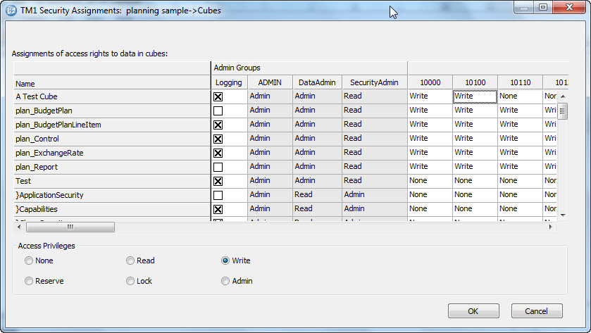

I assign Write access to group 10100 via the dialog:
03 Cube Security.jpg (121.34 KiB) Viewed 13573 times
Look at the dimension security again and you can see that access was assigned to 10100 without me needing to do it explicitly, but not to 10000:
04 Dim Security.jpg (219.59 KiB) Viewed 13573 times
When a user in 10000 goes to access the cube they'll get an error that they have no access to the dimensions. When a user in 10100 does they'll be fine. The two securities may be separate entities, but clearly there are some smarts built into the dialog that will automatically update the security access to the dimension.

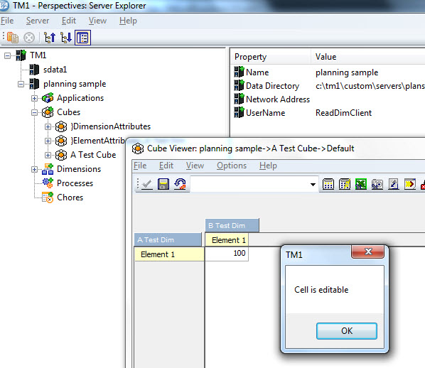

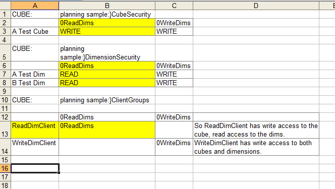

Consider the following situation where two users have write access to a cube, but one has write access to its dimension and the other has only read access:
One might expect, if Read access to the dimensions meant Read access to the cube, that the ReadDimClient user would not be able to write a value into the cube and yet:
So what's the real difference between Read and Write for dimensions?
