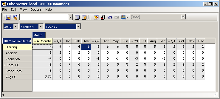

OK, I've created a dummy cube called HC. Basically it has the same structure as my original Headcount cube, but I discarded the unnecessary dimensions and elements to simplify things.
The dimensions of HC and their elements are:
1. Year: 2010, 2011, 2012
2. Version: Version 1, Version 2, Version 3
3. Month: Jan-Dec + Q1-Q4 + All Months (the usual hierarchy)
4. Cost Center: 100ABC, 200DEF, 300GHI
5. HC Measure:
___ C: Total HC
______N: Starting
______N: Addition
______N: Reduction
___ N: Grand Total
___ N: Avg HC
How the cube works:
Starting can only be inputed for January, while the Starting value of other months are taken from the Total HC of its previous month.
Total HC of each month is a consolidation of Starting, Addition, and Reduction.
The Starting of each quarter equals the Starting of that quarter's first month. So, Starting Q1 equals Starting Jan, Starting Q2 equals Apr, and so on.
The Total HC of each quarter equals the Total HC of that quarter's last month. So, Total HC Q1 equals Total HC Mar, Total HC Q2 equals Total HC Jun, and so on.
The Starting of All Months equals Starting Q1, equals Starting January.
The Total HC of All Months equals Total HC Q4, equals Total HC Dec.
Grand Total and Avg HC only exist for All Months, while for other Month elements the value is 0 (to prevent the user from inputing any numbers).
Grand Total equals the Total HC Q4 and equals the Total HC Dec. So basically its value is the same with Total HC All Months, but I need as Grand Total for special purpose.
Avg HC is calculated from the sum of Total HC of each quarter divided by 4.

The view:
HC View.PNG (21.95 KiB) Viewed 14310 times

So the reason the Grand Total and AVG HC get suppressed is that they are consolidations with all zero and unfed values below them. To the TM1 calculation engine since the members of the consolidation are not populated the consolidation itself does not exist.
Your best bet is to something like this
(EDIT : You might need to tweak the !Year reference).
['Grand Total', 'DEC'] =N: DB ('HC', !Year, !Version, 'Dec', !Cost Center, 'Total HC');
# Avg HC equal the sum of Total HC divided by 4
['Avg HC', 'DEC'] = N:(
DB ('HC', !Year, !Version, 'Q1', !Cost Center, 'Total HC') +
DB ('HC', !Year, !Version, 'Q2', !Cost Center, 'Total HC') +
DB ('HC', !Year, !Version, 'Q3', !Cost Center, 'Total HC') +
DB ('HC', !Year, !Version, 'Q4', !Cost Center, 'Total HC')
\ 4;
# lock Grand Total and Avg HC of each month
[{'Grand Total', 'Avg HC'}] = N: 0;
Make sure you fed the DEC values in the normal way, the consolidation will then work as normal and show the correct total since only DEC is populated.
Hope this gives you an idea of the direction you need to go, C level rules are one of the more tricky aspects of rule writing!

I see... very effective indeed. I never thought to assign the value to the December or any other months instead of the All Months.
Thanks Steve, I really appreciate your help.
And btw, what do you mean by this?
Steve Rowe wrote:(EDIT : You might need to tweak the !Year reference).

The edit I made was just because I was not sure about your dimensions and it was early and I was tired!
( When you specify Dec on the left hand side of the rule that means that you will be looking at Dec on the right if you are using the ! reference, but if you have hard coded references you will be fine, plus !Year is a different dimension anyway.....)
