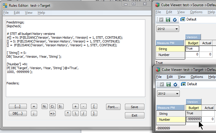

Here are the images and rules. There are two identical cubes: Source and Target. The dimensions are Version, Year and Measure.
In the Version dim, Actual version is a child of "Version History" parent while Budget is not. In the Measure dim, the elements are String and Number. Only Target cube has rules. It pulls the String value from Source cube over to its own String measure. Then, if the calculated String value is "True", Number value will return 1000, else it will be -9999999.
Case A - Using [] = S: and []
Result: Number is calculated to be -999999 even though String (calculated) is "True" i.e. failed. STET is working in Actual version.
Case A_S and All_Fail.png (48.65 KiB) Viewed 18135 times

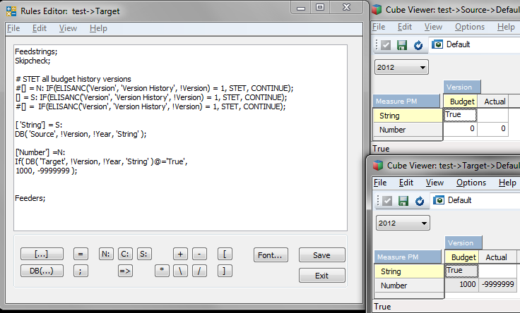

Case B - Using [] = S: ONNLY
Result: Number is calculated as 1000 as String (calculated) is "True" i.e. correct. STET for string is working in Actual version.
Case B_S only.png (48.67 KiB) Viewed 18135 times

Case F: No STET at all
Result: Number = 1000 i.e. correct.

Re: Best option for not calculating other versions in cube
Posted: Fri Oct 05, 2012 9:10 am
by Steve Rowe
Yuck, Agreed this is a bug.
