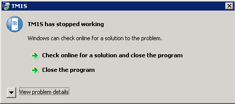

I have question about error of TM1. I start server TM1 and open TM1 Perspective and TM1Architect for build model and slice data via TM1 Perspective . After then have error box 'TM1S has stopped working ' . and that's close ,TM1 Server is close and It's not save data .

I'm copy this error via snapshort

Hi Kung,
It's teng teng teng caused by out of memory

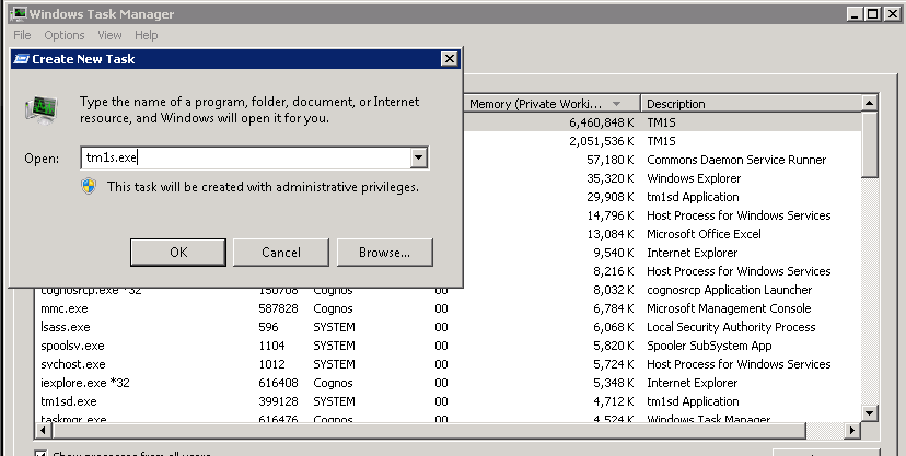

This's server clash because occur frequently If you open the folder that contains files or file a lot of heavy.
Normally it will take over and ' TM1s has stop working '
It will open up once again.
If it does not open it, press crt alt del and select task manager.
And then press the right menu bar and select a file to write the new task (run. ..).
Type TM1S.exe, and then everything will be back.
But Who 's have solution for this problem ,Please tell me ?
