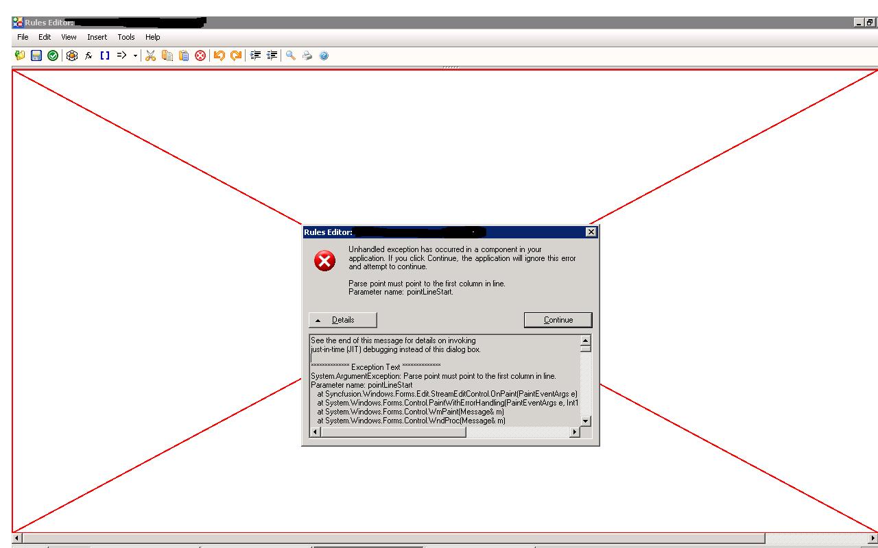

When ever i Type ' in the rules editor am getting this error. I attached the picture.Please have a look and let me know if any one knows about it.
- rules error.JPG (89.56 KiB) Viewed 12969 times

I have also faced the same problem long time back when working with the earlier version of TM1.
The causes for this error is basically with the Dot Net Framework and/or Virtual Memory.
So please try these steps,
1. Re-Install the dot net frame work relevant to the TM1 version you are working.
2. There is not enough virtual memory to load the Rules Editor. Increase the virtual memory and try it.

I dont think its a bug in TM1. This error seems to be more related to either .NET Framework or Windows itself.

You are trying to use the 'new' rules editor which was introduced in 9.1. It's pretty, but doesn't work properly. From 9.4 onwards the default moved back to the 'old' editor, which works.

okay it got fixed by itself.
I just tried to delete the rules editor and wrote all the rules again and now it is working.. will update if it get back to same error once again.
