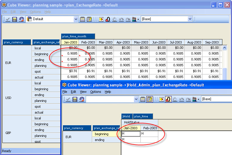

When you place HOLD on a cell in any cube TM1 creates a Control cube with name }Hold_UserName_CubeName. The cells which are on Hold will have a value of H in this control cube. See the attachment for details.
If you will write a TI Process which writes H in the }Hold_UserName_CubeName for the required intersection then you can place Hold on these cells. To remove/release the Hold you will have to erase the value of H from the control cube - once again you can do this within a TI Process.

- Hold Consolidate in TI Process
- TM1_HoldConsolidate.jpg (153.61 KiB) Viewed 13518 times
