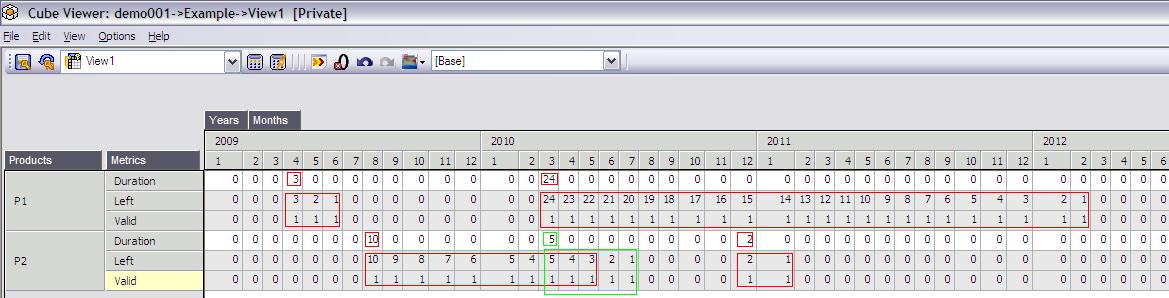

Although I would also probably (facing the real problem) lean towards TI I could not resist of trying to make such an example in rules.
My solution here does not concentrate on efficiency (no skipcheck/feeders etc.), it just shows, how it could be implemented. But maybe in real life your dimensions/cubes are too big to use the "rules" approach.
1. You create dimensions Years, Months and Products in a regular way, for the Months dimension you use names like '1', '2', ..., '12'. The Metrics dimension consists of 'Duration', 'Left' and 'Valid' elements (I needed to add the one in the middle).
2. You create 'Example' cube with dimensions order of 'Years', 'Months', 'Products', 'Metrics'.
3. In a view you pick 'Duration' (my picklist consists of static values 1, 2, ..., 12, 24, 36, 48 to make it simple in rules, of course you could use a description like '3 years' and then convert it somewhere to value 36) and you can see the 'Valid' flag in the same cube (as shown on screenshot 'DurationAndValidExample.jpg').
4. To make it work this way you should put rule like this (checking the "previous month" coordinates could be done via attributes):
I marked in red frames all inserted and all calculated-to-non-zero values. I also did a case when one period is not finished yet and I defined a new period to start (green frame for the new one).
HTH
['Left']=IF
['Duration']>0,
['Duration'],
IF
DB('Example',
STR(NUMBR(!Years)-IF(!Months@='1',1,0),4,0),
IF(!Months@='1','12',STR(NUMBR(!Months)-1,2,0)),
!Products,!Metrics)>0,
DB('Example',
!Products,!Metrics)-1,
0
['Valid']=SIGN(['Left']);
HTH
- DurationAndValidExample.JPG (74.43 KiB) Viewed 4817 times
