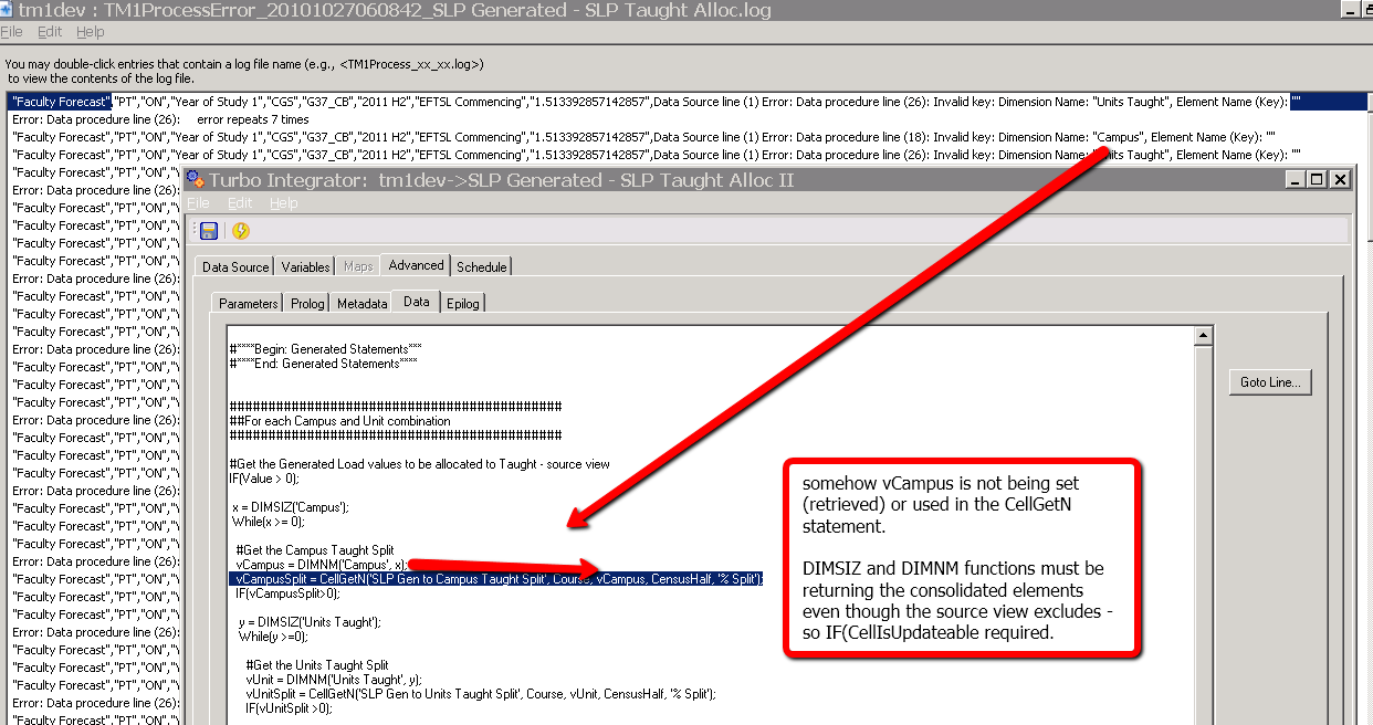

Hi guys - I am having a bit of trouble with my TI process.. I can't seem to get the element name I want into the cellputN statement in my process. Or maybe it's that I can't actually retrieve the element name using DIMNM and an index. Does anything stand out (other than the big red arrows thanks to JING screen capture) in the attached?
The process is an allocation. The target cube has two dimensions not in the source cube. The allocation split for these dimensions comes from two assumption cubes retreived using a cellgetN.
Rules? Overfeeding on these two dimensions consumed way to much ram if I try and rule the allocation.
9.5.1 TM1 TI allocation process
- rollo19

What stands out is that both your loops count down to zero by using
While(x >= 0);
and
While(y >=0);
In that case you will get errors because you are trying to retrieve/use the element with index '0' which does not exist.
So if your concern are the errors that should be fixed by using
While(x > 0);
and
While(y > 0);
Not sure what the problem is if you don't get any names/values at all.

Oops - fixed that and it's running. Thanks very much!
.. and it's still running... This is a large but sparse target cube - source has some 68,000 records by some 3,500 in allocation target dim 1 by 50 in allocation target dim 2 = 11,900,000,000 possible allocation targets the DIMNM loops must trawl through and test if the cellisupdateable, calc allocation value, cellget & cellput.. So far processing ~1 record per second so perhaps 18hrs.
Does anyone have any examples of such an allocation process or approach which might be more efficient/faster than this?
I also found it was quicker to skip the IF(Allocation Split >0) check and just run through all elements in the target allocation dimensions.
