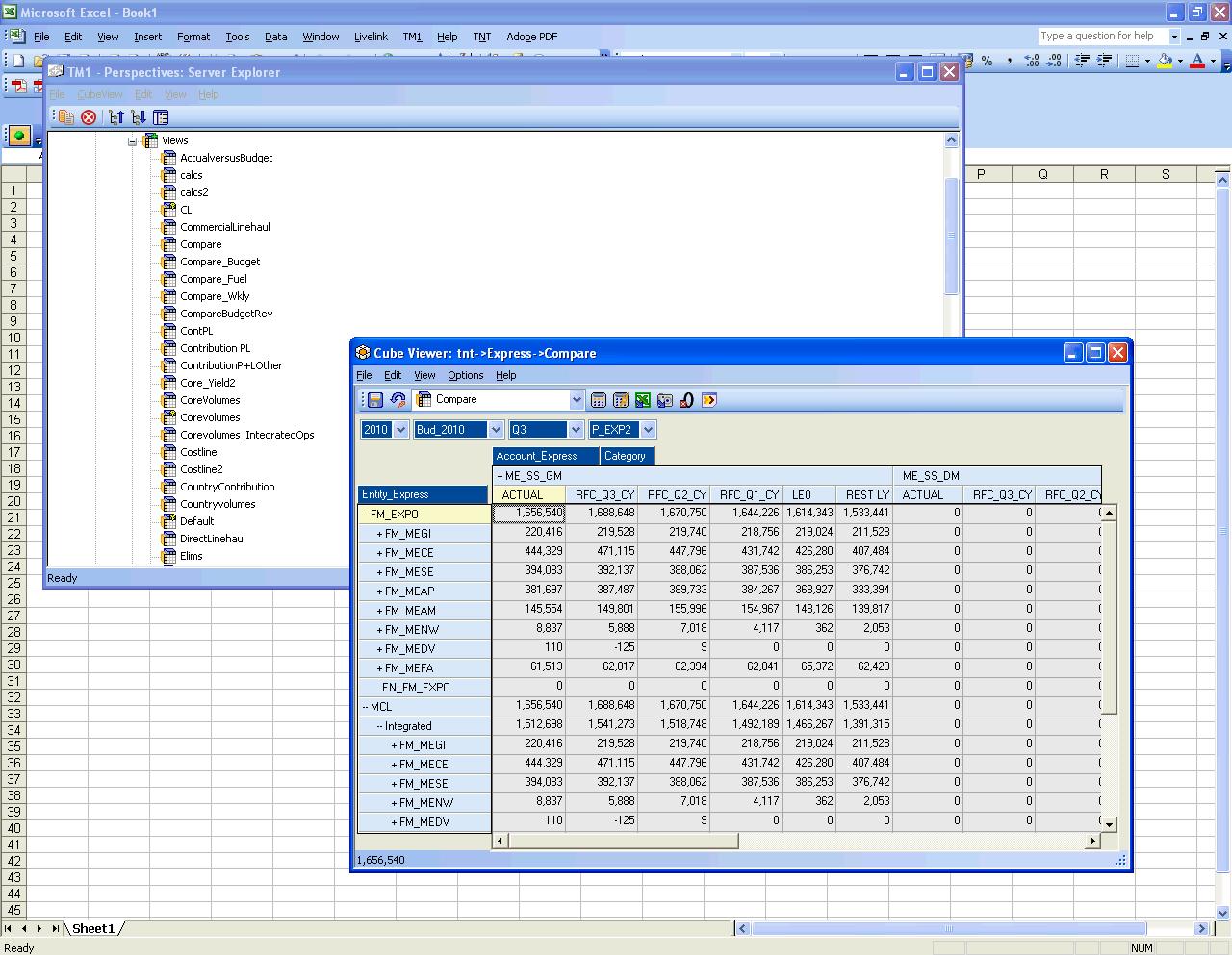

]Hey sorry for being late in this , again please be advised of the following
Again what i was doing
- Open the TM1 Explorer
- Open one of the view screens
- Closed excel from the cross on the top
- Excel Frozen
- TM1 Windows still active
- Only way to close excel is to End Task
Screens below showing the issue
Windows opened before clicking on cross to close excel

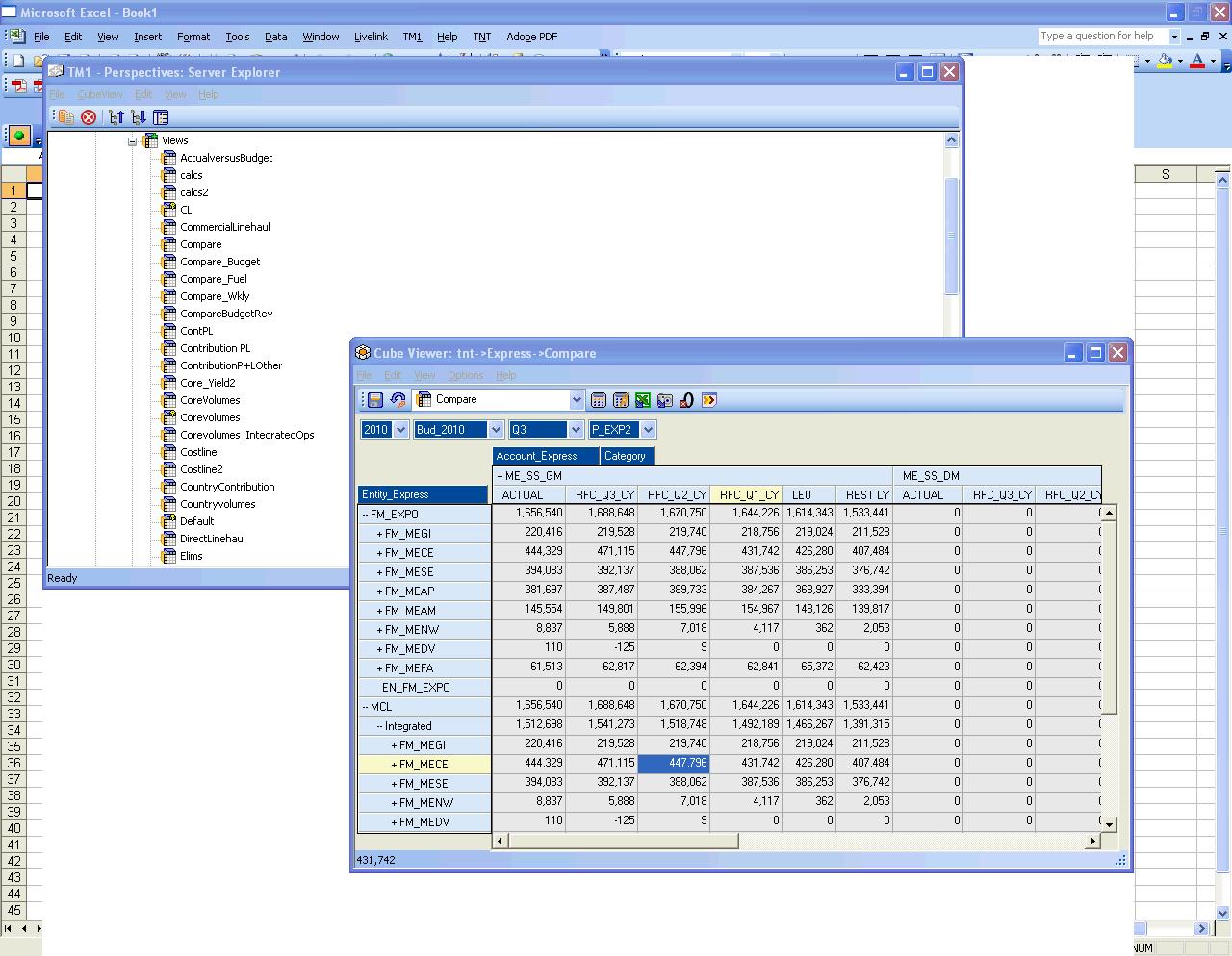

Excel Frozen , TM1 Still active
tm1-tmaactiveexcel frozen.JPG (197.46 KiB) Viewed 18843 times
ABOOD
Posts: 8
Joined: Thu Oct 14, 2010 7:14 am
Version: 9.1
Excel Version: 2003
Location: Haarlem
Re: Excel Crash
Post by ABOOD »
Hey there , Any idea what's the issue above , appreciate your help
