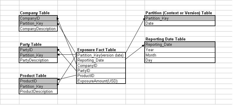

Each day a new partition is created for the full stack of data available on that day. Partitions in our case represent a version of the data on that day(it's a lazy way of keeping a history, instead of determining what's changed, new snapshot of data is created, regardless if it's changed or not, and appended to the same tables with a new partition_key). This is viewed as a reporting context. However we do have a separate date dimension - Reporting Date, which is indicative of the date we've received the exposure data. For each partition or context we will have a full stack of days - all reported exposures to date....
I've mocked up a simple star schema to create a visual... Each Dimension table have 2 keys that I would probably need to link the data with, actual Primary Key, like CompanyID and a context/version date - Partition_Key, hence creating a confusion...
Please help.
Ann

Here is our schema sample. Thanks, Ann
Re: Cube Desing Question - partioned by date db model
I don't understand what you're asking. If you asking for the structure of the cube that is easy, it should look just like your Exposure Fact Table, with a dimension for each of these fields. If it's something else you need to be more specific. I will tell you that you need to stop thinking about things in a relational database mind-set. OLAP cubes are different and require a new way of thinking. Good luck.

ABRANDE wrote: I've mocked up a simple star schema to create a visual... Each Dimension table have 2 keys that I would probably need to link the data with, actual Primary Key, like CompanyID and a context/version date - Partition_Key, hence creating a confusion...
As we have explained you earlier that you do not need to have the Partition_Key in the Company, Party and the Product Dimension.
Hope it helps!

Thank you, so much for your replies! I am really after figuring out how to best model the cube, dimensions, etc for this particular case...
I am trying to twist my brain a bit, to think in the OLAP terms...
Here is my question: If I drop the Partition Key from the Reference data tables, like Party, Company, Product, then I will only be able to load one version of the truth(reference data) for a given partition, since the Description for the same ProductID might change depending which partition users are looking at, but the ProductID will be the same... So If I load this sample dataset into the Product Table, without specifying partition then it will look like this:
ProductID: 1
ProductDescription: Bonds (description for partition date: Jan 01, 2010)
ProductID: 1
ProductDescription: Municipal Bonds (description for partition date: Jan 02, 2010)
Wouldn't it be a problem then? How would I then specify in the fact table which description needs to be picked up for a given partition, since the ProductIDs will be the same?
Thank you,
Ann
