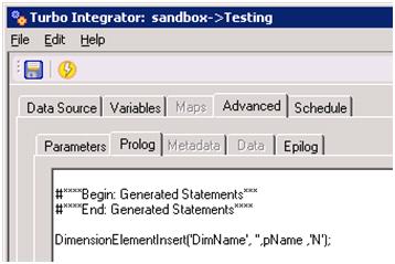

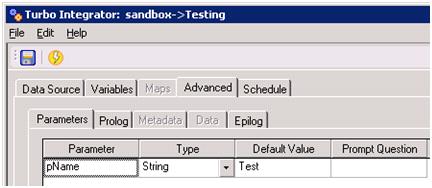

Only thing listed in Prolog is this
DimensionElementInsert('DimName', '',pName ,'N');
pRollup in the bottom picture is no longer there. I had it in there when I was attempting to add the element to a rollup.
Parameters Tab

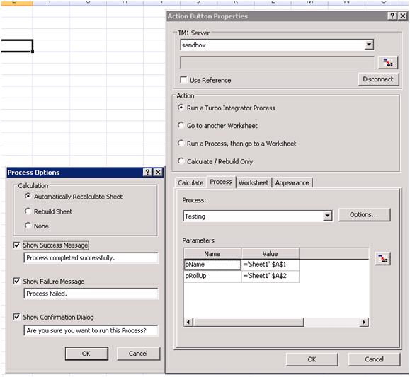

Excel Button
Button Options.JPG (44.71 KiB) Viewed 13234 times

You have got 'DimName' in quotes - do you have a dimension literally called 'DimName'?
Otherwise nothing else is leaping out at me - I'd try putting an asciioutput in the prolog and dumping out the parameter to see what information is getting passed to the process.

Ok so this is a bit odd. I decided to look at the properties of the button (The excel properties using the developer tab). When I created the button I picked a TI process from 1 of the 3 servers we have up and running. The button itself listed the server as the first one in the list not the one I selected when creating the button. Therefore it appears the button was attempting to run the TI process but was pointed to the wrong server. After manually changing it back the TI process works and the parameters are being picked up.
Only other issue I have now is that I was hoping to use the picklist value from a TM1 cube to pass the selection to a parameter. Unfortunately this came back as null. Ill have to keep testing.
Im assuming this is odd behavior though? the server i first pick when adding the button isn't the one being written into the properties when I click finish.
