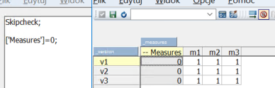

I do not want to show any values at consolidated element "Measures", because it would be misleading since children of this Element are just different measures (some are percenteges, some not etc.). I created calculation:
['Measures']=0;
Unfortunately this consolidation is still visible adter suppressing zeros. I guess because rule on this consolidation is not fed and it still containg these consolidated values, but is it any way to feed it? Is it worth to feed it in terms of performance (assumming I'm dealing with very large cubes)?

michalb wrote: Wed Aug 31, 2022 3:38 pm I do not want to show any values at consolidated element "Measures", because it would be misleading since children of this Element are just different measures (some are percenteges, some not etc.)
Elaborating on what Wim rightly suggested, a good rule of thumb is to set the weights to zero in a parent-child relationship so you're not aggregating items that shouldn't be aggregated, i.e. a value and a percentage.
michalb wrote: Wed Aug 31, 2022 3:38 pm I created calculation:
['Measures']=0;
A C-level rule is nothing more than an overlay to natural value (consolidation). That natural value is still there hiding under the overlay c-level rule. The only way to make sure this is zero-suppressed is to ensure all child elements have a value of zero, so the natural consolidation is zero.
Given natural consolidation, what usually trips up people is the opposite. Setting a rule of ['Measures']=C:1; continues to be zero-suppressed until that consolidation naturally has an N-level child element with a non-zero weight -and- a non-zero value.
michalb wrote: Wed Aug 31, 2022 3:38 pm Is it worth to feed it in terms of performance (assumming I'm dealing with very large cubes)?
Why feed if you want it hidden (and you don't feed C-level items).
One additional way to "hide" is to do element/cell security ... you can set the c-level to "NONE". That way it's hidden for non-admin users.
