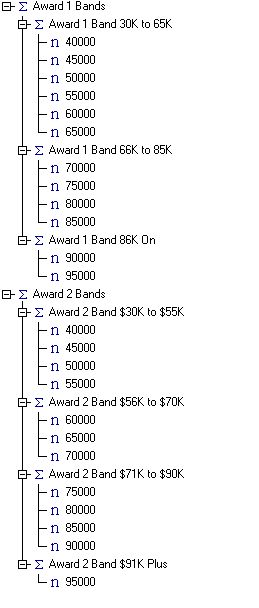

Re: Multiple Hierarchies - expensive?
GPC wrote:
You would then have two hierarchies of consolidations, each of which consolidates all of the salary elements which fall into that particular band.
I'm not aware of a way that TM1 can consolidate into "Bands". If it can, I would be very interested to hear how.
Like that:
Joe Smith has a salary of $70K. His data is stored against the element 70000. He therefore falls into Award 1 Band 66K to 85K and Award 2 Band $56K to $70K. You can select either of those elements, and if every other selection is the same you still end up with good old Joe's values.
Sally Brown has a salary of $80K. Her data is stored against the element 80000. If you select Award 1 Band 66K to 85K you'll get both Joe and Sally's numbers, but if you select Award 2 Band $56K to $70K you get Joe's alone. In terms of being able to select the bands that you want, there's no real difference between that and having the bands as N level elements themselves.
As Lotsaram was alluding to, it would be worthwhile to go through the manuals to get a better handle on what hierarchies actually are.
GPC wrote: It seems then, that multiple dimensions, while they would seem to be logically incorrect, as they are both "banding" the same data item, is the more economical solution as far as cell usgage/memory consumption are concerned.
As I said, it has nothing to do with the number of dimensions. The only thing it has to do with is whether you're duplicating data or not. If you are, you use more memory. If you're not, you don't.
GPC wrote: of course, if the Salaries were all multiples of $5,000 as in your example, we could use simple alternate hierarchies. Unfortunately they are not, there are thousands of discrete individual salaries.
That makes what difference, exactly? So Joe's salary is 72426.85. That's the name of your element instead of 70000. Such an element can still consolidate into two different hierarchies. All of the thousands of salaries can still consolidate into bands. All you need to do is have the TI that uploads the data work out which bands they fall into and assign the elements accordingly. It's hardly an excessively complex task.
