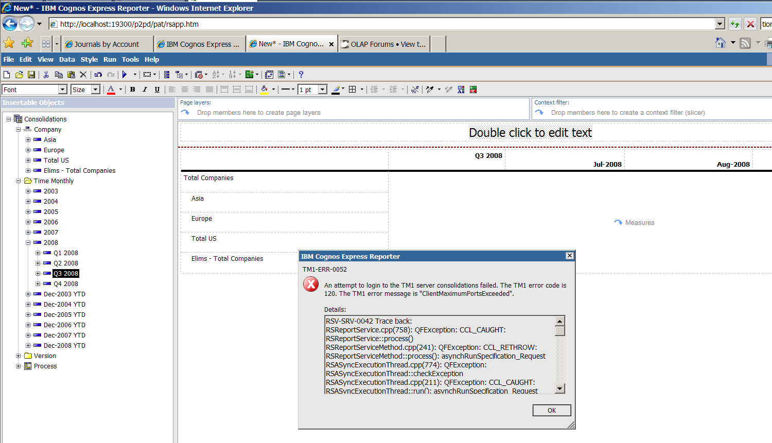

I am getting an interesting error when creating a Report in Express Author mode: "ClientMaximumPortsExceeded"

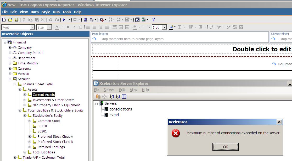

And after receiving this, if I go into Architect I get: "Maximum Number of Connections Exceeded on the server"

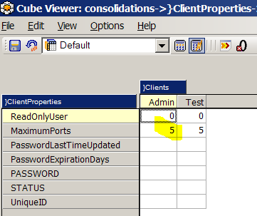

Someone mentioned on this forum }ClientProperties - I ended up changing MaximumPorts to 20.. still received the above errors.

Post by rollo19 »
ah thanks MC - tm1s.lic file, MAX_USERS was set to 5 which should have been enough while using Reporter (Report Studio). Perhaps Report Studio creates multiple sessions with TM1 while building a report as even with 5 I shouldn't have been getting that error. MAX_USERS is now set to 99999 and I don't get the error.
