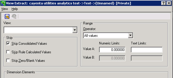

Alright, I have dig this out. We can do this using a TI Process. Do the following steps:
Create a TI Process
On Data source tab, slect TM1 data source type.
Click on Browse (to select a View name)
Now here is the trick -> Click on Create View button
On the View Extract dialog, uncheck the Skip Zero/Blank] Values. See the attachment.
Click OK. Provide a new name for the view you have just created
On variable tab, create a new Variable (of Data type) and its Formula should be vMyValue = 1;
Map your variable (Elements and data)
Run the process.
This should work for you.
Hope it helps!

- View extract to put 1 in the cube
- ViewExtract.jpg (30.4 KiB) Viewed 12622 times
