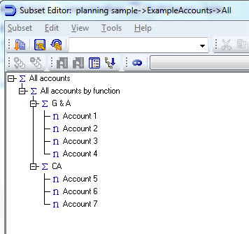

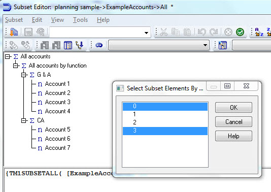

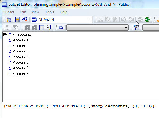

OK, what I mean is this. Let's suppose that you have a single hierarchy like so:
As I'm guessing you know, N elements are at level 0, the functional consolidations will be level 1, the All Accounts By Function one is at level 2, and the All Accounts one is at level 3. This enables you to record arguably the simplest dynamic subset expression there is, select by levels:
This gives the expression (and subset) that we can see here (I've tuned the Expression Window on from the View menu so you can see the MDX code at the bottom):

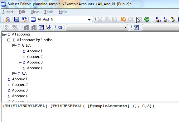

Where this will fail is if, say, you added a new consolidation in to add elements 1 and 2 together and added that consolidation to the G&A one. That would push All Accounts up to level 4 and the simple expression would no longer work. But as long as All Accounts stays at level 3 (or whatever), the expression will work just fine.
Now as I suspect you've discovered, if the users get snoopy and expand the consolidation then yes, you're correct, they will see the N elements twice (as well as the functional consolidations):
If that's a real problem, the only choice you have is to maintain two hierarchies, one of which has the functional groupings and one of which is just a total element with the N level ones below it.

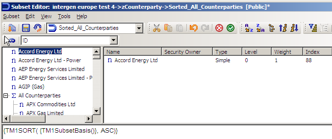

I have a similar question. I'd like to make a dynamic subset that always shows a sorted list of leaf elements in my dimension which I have under a single consolidation: "All Counterparties". The problem is that when I apply the sort using MDX it sorts everything including the consolidation. This is what it looks like:
Sorting All Counterparties.png (30.21 KiB) Viewed 8850 times

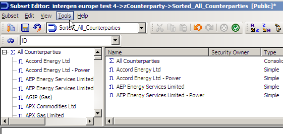

and this is what I'd like:
Sorting All Counterparties_desired.png (24.94 KiB) Viewed 8850 times
Is there a way of writing this in MDX?
