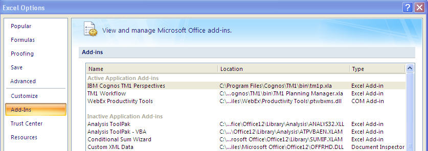

What is the TM1 version on the Server and version on your machine (client)? Also which Operating system and version of Excel 2007 you are using? You need Excel 2007 Service Pack 2 as well.
Check the Excel Addins to see it if TM1 addin has been installed properly or not. See the attached screen shot.
You can also check TM1\bin folder for TM1PRibbonx.xlam file to see if it is there.
- Excel Addins options
- ExcelAddins.jpg (74.67 KiB) Viewed 5967 times
