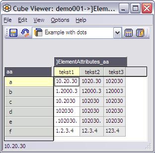

It is actual for tabs (Prolog, Metadata, Data, Epilog) of TI, But if i should create variable with formula?
jstrygner
- Posts: 195
- Version: 9.5.2 FP3
Re: Delete characters from String
Do you mean in Rules?
Loop in TI is great, as it is universal - you may have as many dots inside as you want - it will just work.
If you want to do it via Rules then it is not that elegant, but you can do it if there is a known maximum of dots (e.g. not more than 2).
In such a case you can create a rule like in my example below (what I actually did is I wrote a rule for tekst2 that takes rid of first dot in tekst1, then if you have a maximum of two dots you add a tekst3 that does the same with tekst2, as we can see you can easily expand it in case of larger amount of dots).
If you want, you can try to type it in one rule but then it gets even more non-elegant.
The rule is like this (I used attributes cube for this example):
As you can see in the picture below, it works independently of where the dots are (elements a and b), it does not matter if there are less dots (elements c and d), if the dots are at the beginning or end of a string (element e) but in my case dots remain if there are more than two of them (element f).
HTH
