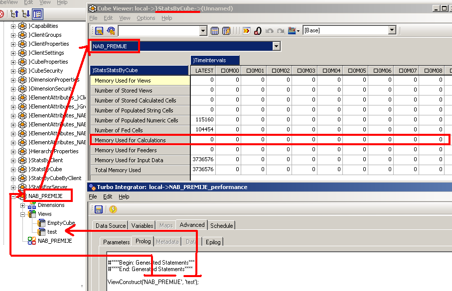

I have read a "TM1 Operational Guide" on topic "Performance Monitor", but I am getting "Memory Used for Calculation" = 0 and performance of report from Cognos BI Report Studio hasn't improved.
I did the following:
1. Right click on my cube NAB_PREMIJE and selected "Export as Text Data"
2. Unchecked "Skip Consolidated Values", Skip Rule Calculated View is unchecked and grayed out, Skip Zero/Blank Values is checked
3. From Dimension Element section I have selected some members for dimensions, this changed "All" selection to some names of elements.
4. Saved view as public view with name "test".
5. Created TI process. Left all settings unchecked and went to Advanced | Prolog tab and wrote function ViewConstruct('NAB_PREMIJE', 'test');
and run a process. Process completed successfully.
6. Run some reports from Cognos BI Report Studio (performance hasn't changed)
7. Then have waited for minute or two and checked in TM1 Architect measure "Memory Used for Calculations" for cube }StatsByCube and there is always 0 displayed.
Am I doing something wrong? Why is there 0 displayed for LATEST --> Memory Used for Calculations? And why are there 0 displayed for all of the elements except LATEST for }TimeIntervals? According to documentation The Operational Guide the values should be copied from to 0Mxx every minute. But I see no history data in the }TimeIntevals cube.?

Your view isn't quite right. Try exporting it to a file and looking through it in Excel.
On Performance Monitor, the history is written by minute. If you start it at 14:20, the first slice will be written against 0M20. Latest is always the latest though.

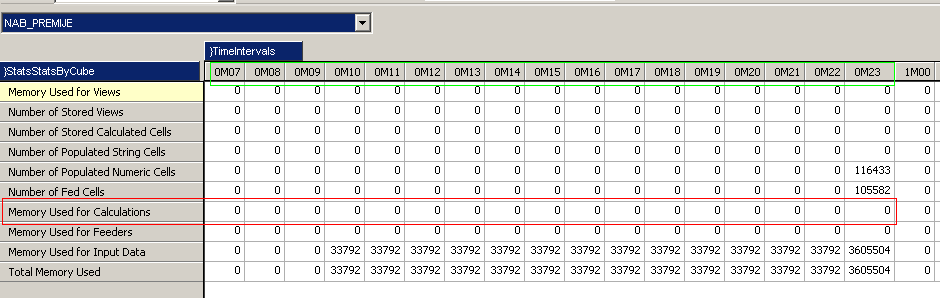

I have exported the file and looked it in Excel and there are some perfectly looking rows. Are there any instructions how should view look like?David Usherwood wrote:Your view isn't quite right. Try exporting it to a file and looking through it in Excel.
I have read the documentation, but all of the columns except for LATEST does not have any data beside zero, which is strange to me.David Usherwood wrote:On Performance Monitor, the history is written by minute. If you start it at 14:20, the first slice will be written against 0M20. Latest is always the latest though.
Yes I see there is a square before 0M00 etc, but how to remove this square? I have tried to right click on dimension and "Edit Dimension Structure" is grayed out. Any tip how to remove this squares?Andy Key wrote:The problem is with your }TimeIntervals dimension. I think it was a version of 9.4 that messed these up. You need to edit the dimension and re-create every element, except for Latest, but without the control character (the square at the start) so you end up with 0M00, 0M01 etc. rather than what you currently have.

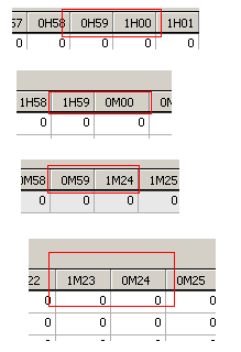

I have swapped H and M in a process and run it again. But now I am facing several additional problems in dimension }TimeIntervals in cube }StatsByCube:
1. There is still: 0H00 ... 0H59 instead of 0H00 ... 0H23
2. There is still: 1H00 ... 1H59 instead of 1H00 ... 1H23
3. Order of 0Mxx and 1Mxx are not properly sorted it appears:
0M00 ... OM23, 1M00, ... 1M23, 0M24 ... 0M59, 1M24, ... 1M59.
- time.png (2.99 KiB) Viewed 13981 times
