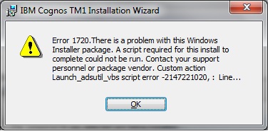

Anyway, when I try to install TM1Web I get a generic 1720 error (see picture below). I've tried searching around for the usual culprits for 1720 errors, but as it's a generic error it could be anything. I see from this post that someone has managed to get it running, so it would appear that there aren't fundamental problems with Windows 7 and Web.
Anyone who's more au fait with Windows 7 than I am got any ideas? I've always been running it as administrator and I've tried the compatibility mode. I've also tried setting the "User Account Control Settings" to the lowest possible level.

As I've mentioned I haven't tried Web under Windows 7 but when you ran the Install program did you right click on it and select "Run as Administrator"? I hear what you say about using an administrator account and the UAC settings, but unfortunately with Vista / 7 this doesn't always mean that administrator privileges are assigned unless you explicitly specify them.

Figured it out with a little help from another forum that someone helpfully pointed me to. Turns out the problem is with IIS.
The supported environment matrix for TM1 (through 9.4 MR1 FP2) does not include support for IIS 7. In most cases, attempting to install TM1Web to an IIS 7 web server will fail altogether. The reason for this is that TM1Web relies on the IIS metabase - the centralized configuration store used by IIS 5 and IIS 6. With IIS 7, the metabase has been replaced by a new delegated configuration system based on a hierarchy of distributed XML configuration files.
In order to successfully install and configure TM1Web to work on IIS7, the Metabase Compatibility component of IIS 7.0 needs to be installed on the machine. This component is not installed by default. On Windows Server® 2008 builds, you can use the Server Manager tool (Start->Administrative Tools->Server Manager), and check the "IIS 6.0 Management Compatibility" component to install it. For Windows XP, Vista, or Server 2003 you can use the Microsoft Web Platform Installer - a free tool available on the Microsoft IIS site http://www.microsoft.com/web/downloads/platform.aspx Install and launch the Web Platform Installer, and select the "Web Platform" tab. Next to the "Web Server" item, click "Customize" to display the available IIS configuration options. Scroll to the group of items labeled "Compatability", place a check in the box beside "IIS Metabase Compatability", and click the Install button.
Once the Metabase Compatibility feature is enabled, you should be able to complete the install of TM1Web on your IIS7 machine. Once TM1Web is installed, there's one additional configuration step. Start the Internet Information Services (IIS) Manager (typically available via Control Panel -> Administrative Tools). Browse the folders in the left pane and select the item TM1Web (typically found under "Machine Name" -> Sites -> Default Web Site). In the right panel, click the icon for "Default Document". Add an entry "TM1WebLogin.aspx" if it is not already defined. You may need to restart the default web site.

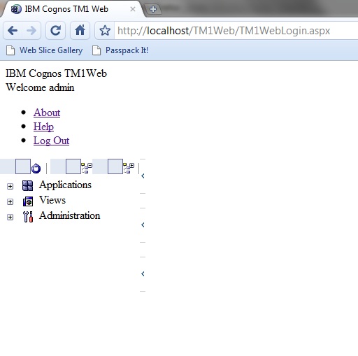

Now just got to figure out why the web page looks like this on Firefox, IE and Chrome (I've cropped the rest which is all whitespace).

Well I've discovered how to fix part of it - by removing the line
<add name="ScriptModule" preCondition="integratedMode" type="System.Web.Handlers.ScriptModule, System.Web.Extensions, Version=3.5.0.0, Culture=neutral, PublicKeyToken=31bf3856ad364e35" />
from web.config. If I do that then I can login with the CSS working (for the most part), and the menu stuff working on the left, however I am left with just white space on the right. Can't view any cubes or reports or anything. Given that this particular bit of code in the config looks like it only deals with integrated login I'm thinking that my problem lies elsewhere, so I might just leave it commented out.

I remember using the compatibility mode and the web pages appearing just like the screenshots you posted. I think I solved this by giving Everyone full rights on the CSS and Images directory (which is OK on my laptop where I only run IIS for TM1Web and only for demo purposes).

I had a same error when I install TM1 to Windows 7 32 version, and I resolve it using by following procedures.
1. Run cmd
2. Execute regedit
3. Find below key and delete it:
HKEY_CURRENT_USER\SOFTWARE\Classes\CLSID\{ B54F3741-5B07-11CF-A4B0-00AA004A55E8}
4. Back up it
5. Delete it
