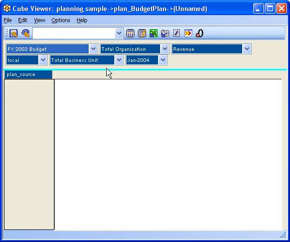

I have crated the Price and Cost cube as default view-
when i open to see the cube - all the dimentions appears in title- one dimention appear in row-
and I am not able to place any dimention on colomn.please advise.
regards,
ravi

What do you mean by you're "not able to place" them into the columns area? What happens when you try?

It go back and sit in row-than column-I think stacking problem?

More obvious issues first; are you sure that you're dragging it to the correct location?
For it to drop into a column you should be seeing the blue horizontal bar like so:
Are you seeing that?
Because if you aren't, and you're seeing the bar shown below, you're dropping it into the rows area.
