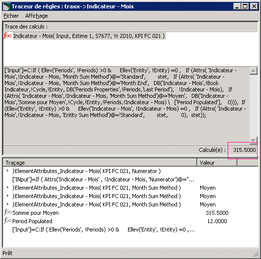

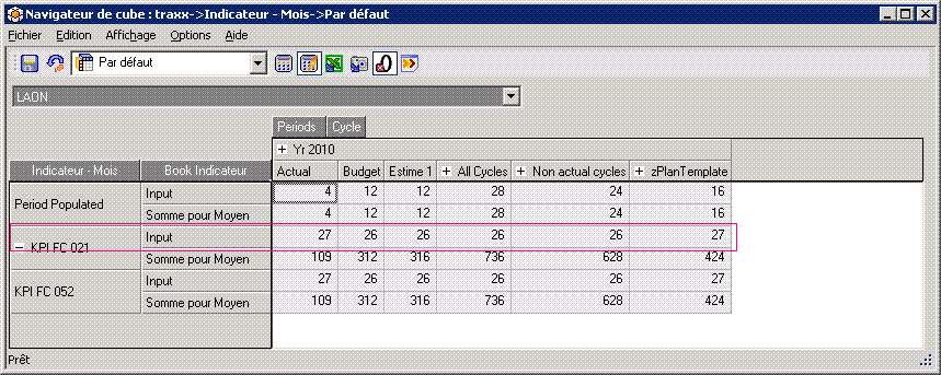

All fairly straight forward stuff.
When the rule is first saved I get the correct result.
with the associated rule trace.

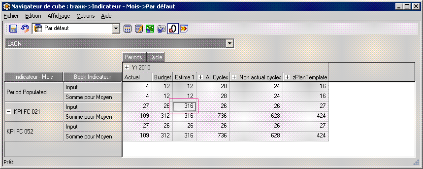

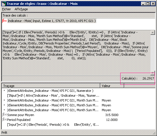

However after repeated presses of the calculate button I get the following result. You will see that the result for Estime 1 has changed. Just to stress the only thing that I have done to make this change is repeated calcs of the cube view. :o
It's pretty repeatable (no server restart as yet), after a rule save the calculation works.
Following repeated recalcs the value changes.
So far it has only affected values in Estime 1, there are no rules that reference Estime 1 directly.
