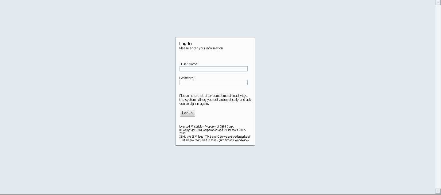

Can I ask if anyone encountered any problem with accessing TM1 web 9.5? Cause if i try accessing it through the server I have no issues at all. But when I try accessing it through other PC in the network, its either the Webpage doesnt load right that you can't see the blue background like Cognos Express and it doesn't load fully, like you can't see the Log In button (1st screenshot).

I did default installation, I already did what you ask and I still can't figure what's cause this problem....I'm assuming network issue since if its a problem with TM1 Web setup, I shouldn't be able to access TM1 Web through the server's IE.
There are some PCs I used to try and connect with the server, some are able to go beyond login but going to beyond login, there's still problem being encounterted that it doesnt load the navigator part of TM1...while there are other PCs where the page is not loading, I tried to ping the server the the response is quick but nothing is loading when I go to the TM1 Web URL. What could be the possible cause of this since both connectivity seems fine.

Well, right now login page is loading okay...not exactly yet what it should be with the blue background but at least I have the Login button there.
So when I log in it does take a lot of time to load and sometimes I get the typical IE problem when it can't find a webpage and at time it won't load anything at all and I'll get a error message on the lower left corner of IE that even that bar that allows you to hide the TM1 Navigation Tree doesn't work either.
But when you check the how much of the server resources is being used, I checked when other PC access the server, it doesn't more much or not at all...which is weird, especially the one where I can't go beyond the login page. When opening a websheet the CPU Usage at most is 98% while other PC accessing TM1 Web,its just 0% or at most 3%. I'm not sure what's preventing the server to communicate with other PC, I think that's the reason the web pages doesnt load properly. Could this be network communication issue between the server & the other units in the network?

Yes I was able to do the permission resetting you mentioned in the previous post. Though graphics for the login page doesn't load fully but I can still log in...but during log in it takes around more than 10 minutes for it to finish loading, and when it does I get the Internet Explorer cannot display the webpage in place of the TM1 Navigation tree and even the default websheet doesn't load.
I tried logging on another different PC and the who main page doesn't load and I just get Internet Explorer cannot display the webpage.
Am I right to assume that this is a network connectivity issue rather than a TM1 Web configuration or permission problem? Or is there additional setting in need to check in IE?

I don't think it's a connectivity issue. That's an all-or-nothing type of problem, and you're getting the top section of the page in your screenshot.

Yeah I also did "iisreset" but the navigation tree and the right portion also didnt load as well even the initial login page's background.
I also gave full control permission to the wwwroot folder...and I still get the same problem.

I had the exact same problem that you are showing in your screen shots. Don't be fooled by the login screen. That loads independently from the TM1 Web.
