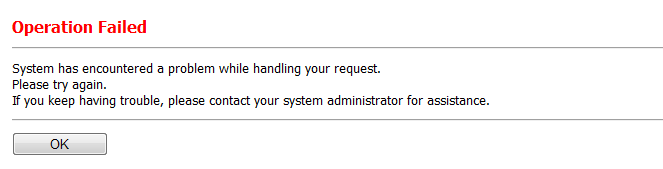

Can somebody helped me out with something. I created a TM1 application in Winsows XP and was able to deploy it via TM1Web and have access to it on a laptop running on Windows 7 and IE 8. But I tried to migrate that application to a Server 2003 and tried to access it with the same client machine, I keep getting an error even just typing out the admin server, it proceeds to the screenshot. Entering the username without the admin name still gets me the same problem.I even tried in on a XP and IE7 and I still get the same error.
But on the server it self I don't get this problem.How do I troubleshoot this problem?

We encountered this when the permissions to TM1Web were not setup correctly. Check your permissions on the ExcelSheet directory and the UserTempDir.To solve this we had to give the authenticated users group access to these directories. What is happening is that TM1 is trying to create some files when the sheet is being accessed and the users do not have rights to create the file.

Actual it happens during login and sometimes during accessing the URL for TM1web. I reconfigured web not to ask for the AdminServer & Servername so I would just need to enter the username and password. Cause prior to this when I enter the AdminServer and push the TAB Button on the keyboard, it doesnt allow me to enter the username instead it goes directly to that page that i attached early on? Is there any security feature in the network that I should look into that's cause this? Cause we i tried accessing TM1web through another server have the same subnet and I was able to access it but with other pcs in the network its either i get an error or the loadin of the site doesn't finish as seen below in the attachment

I am getting the same error on TM1 9.5.2 Contributor.
Everything works fine, until you click on a node to open it. I get the same error that's in this image.
Any solutions?
