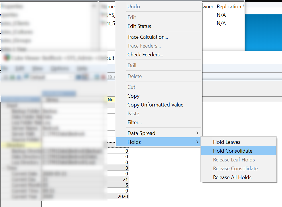

I just had a new CellPutProportionalSpread error and there was no documentation anywhere so I'll share in case anyone else ends up searching for it.
Error: Data procedure line (44): Error with spreading, error type unknown = 184
You will get an error if you try to use CellPutProportionalSpread when there is a Hold on a cell (i.g., Hold Consolidate). Unlike Error Type = 191, this error will make your Spread fail.
I'm using PA 2.0.8
Have a good day !
