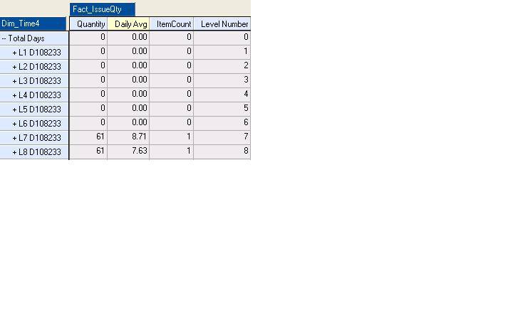

Please see attached file.
I have the following scenario where I calculate the daily average as 'Quantity\Level Number' at a 'C' level across all consolidations in the "Dim_Time4" dimension that begin with "L", (using a STET) however at the "Total Days" level I need the "Daily Average" to be the Sum of all daily averages by "L" consolidations.
So, currently, my rule is : ['Daily Avg']=C:IF(!Dim_Time4 @='Total Days', STET, DB('CubeName', !Dim_Time4, 'Quantity')\DB('CubeName', !Dim_Time4, 'Level Number'));
So, in my example, the intersection of "Total Days" & "Daily Average" should equate to 16.34. I'm guessing to use the ConsolidateChildren function?
How would I use it here?

Ok, had a cuppa coffe and got my eyes open. Give this a try:
But note that ConsolidateChildren is reported to have an adverse impact on performance, although that may only have been in version 8. Maybe the following would be faster, but I don't really know:
['Daily Avg']=ConsolidateChildren('Dim_Time4');
['Total Days', 'Daily Avg']=ConsolidateChildren('Dim_Time4');

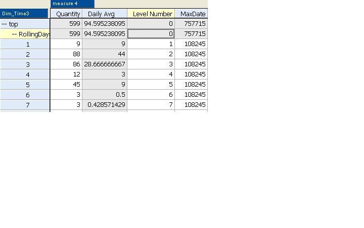

How about if I wanted the intersections of ['top', 'maxdate'] and ['rollingdays', 'maxdate'] not to aggregate, however to be equal to the value of '108245', which represents a date timestamp. Any suggestions?

You can override these consolidations with a hard-coded constant by putting these statements before any other rules that would overlap the same area. (When evaluating a cell, the rule evaluator stops at the first rule it finds applicable to that cell.)
But note, it is usually best to put datestamps and other variable information in an N element where the data can be loaded easily, rather than having to edit the rule every time you need to update the datestamp. (I have been known to use day number zero for this purpose.) If you still want to display it at the top of the hierarchy then the C level rule would use a reference to that N element.
['top', 'maxdate']=C:108245
['rollingdays', 'maxdate']=C:108245

I can't use datestamp or a hardcoded formula for this as the MAXDATE is different for each SKU. So in this cube there is another dimension, which determines the MAXDATE by SKU. Essentially, the MAXDATE is the last date in the range of days for which there was a sale. So I need a formula, which at the consoldiated level takes the value of the MAXDATE from the N level without consolidating for each SKU.
So, for example, SKU1 might have a MAXDATE of 108245, SKU2 might have MAXDATE of 108333.
Re: Changing formula for consolidation to sum rows
Aah, the messes we get into when mixing data with different dimensionality in one cube! [Hint]
Assuming (silly assumption) Dim_Time3 is not more complex than pictured, and that the day '1' always has its MaxDate populated with the desired value, this could be something as simple as:
Otherwise, you need to explain a bit more about the schema.
['rollingdays', 'maxdate']=C:['1', 'maxdate'];
['top', 'maxdate']=C:['rollingdays', 'maxdate'];
