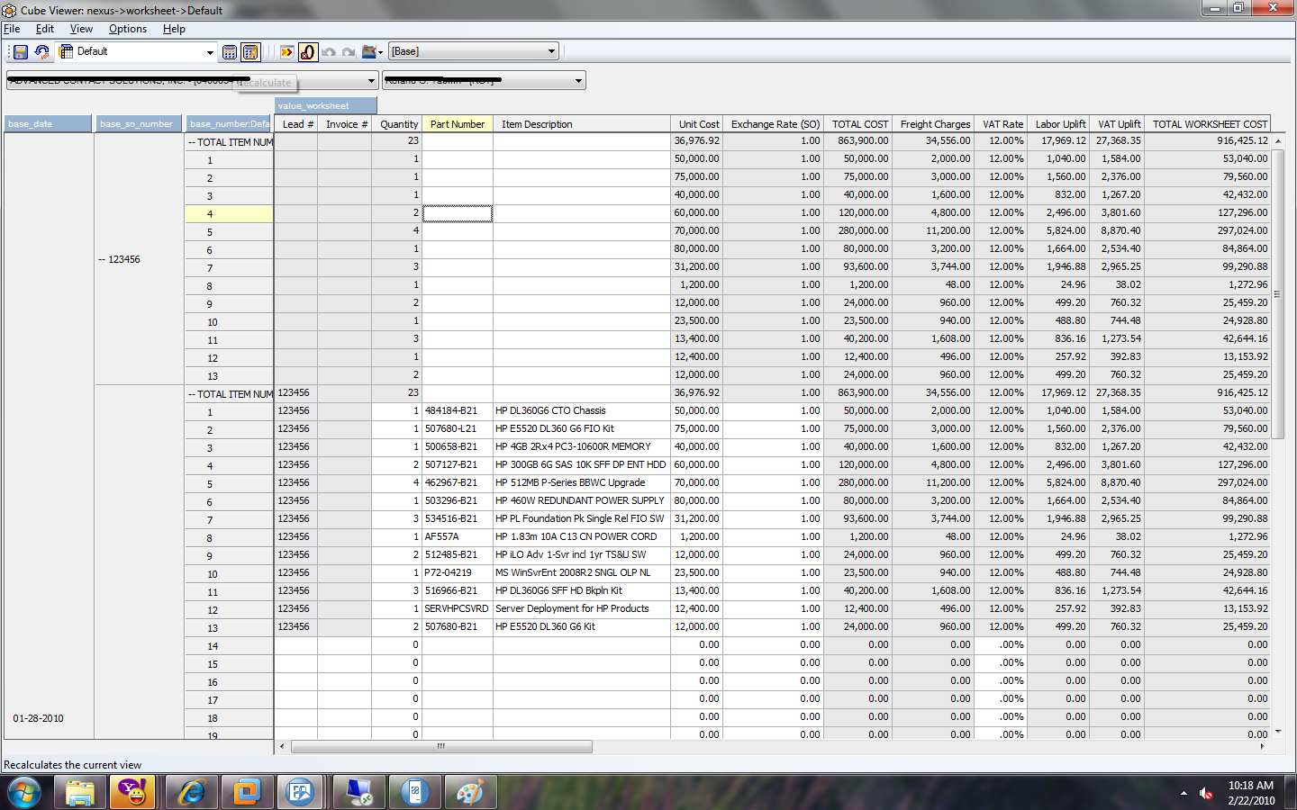

I'd like to ask how come I encounter this how come when I click on the zero suppression, the rows without any values don't suppress. This usually happens along the way when I'm writing the rule for the cube but during data upload it doesn't happen.

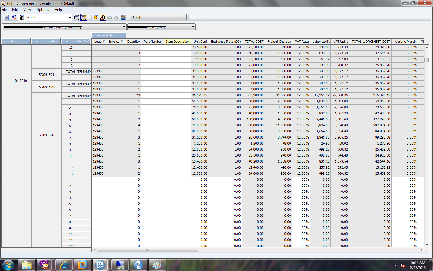

Like for this example, my time dimensions with elements 01-19-2010, 01-27-2010 & 01-28-2010 are the only time element that should have any values for the 2 diemension elements indicated. But the date for 01-04-2010 even without value doesn't suppress.
Also how come even for the indicated time dimension element above, other rows with no value doesn't suppress during zero suppression.
What could be happening wrong?
