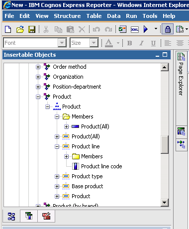

DMR example of what we are expecting (members & levels):

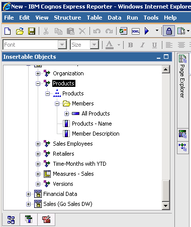

TM1 demo data source (members only):
Tried editing }HierarchyProperties cube
Used TI to RefreshMDXHierarchy('Products');
Saved & restarted server
Re-published FM package
Same result - no levels.
