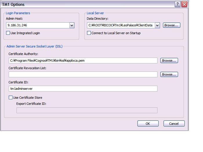

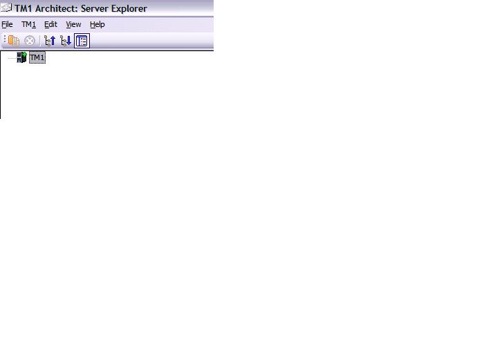

Yes, I can't see the server in Architect, I put the same host ip in Tm1web Admin Host window and Architect option window, then refresh available server, I can't see it at all
Architect option.JPG (43.59 KiB) Viewed 6534 times
No server.JPG (13.16 KiB) Viewed 6535 times
