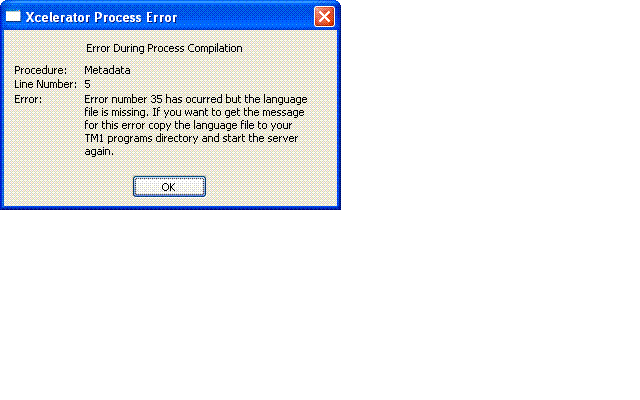

I have installed Cognos Express on my client`s computer via the add in.
All works fine(most of the time) but when we write a TI process in the advanced tab of TI Meta data I get the following error:
See attachment below
I have never seen this error and I think in New Express comes with a language file but for the life of me I can not find.
Anyone else seen this problem?

Hey Herman,
I don't think the problems a missing lagnuage file it's more the error description is missing from the "language file". I get this error sometime when I work on French systems. 99% of the time I get an error message in French, the rest of the time I get a message like that. That's in ordinary 9.0 TM1.
I think it's just a generic error message thrown by the error handler when it can't find the description for an event. Not that it helps much.... Do you get a proper error message for any kind of other TI problem?
That message is probably just as useful as many of the TI error messages anyway!

Steve,
This new logging error is not just with the metadata, but with every possible error with a TI. Because the new logging system in express is different to standard TM1 logging. You now have a specific language file in the logging directory if this is not stored on the local server then logging wont work.
As per release notes:
IBM Cognos Express Does Not Support Additional Instances of TM1 Servers Other Than CXMD Server
Additional TM1 server instances, beyond the installed CXMD server, are not supported in the Manager console. If you try stopping Xcelerator from the Manager console, the process will fail if new TM1 server instances have been created in addition to the CXMD server that is provided with IBM Cognos Express Xcelerator.
Sigh....
Herman
Sigh....
