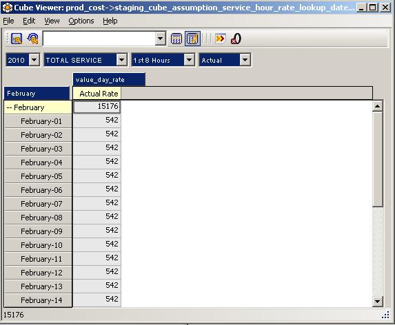

I was wondering if someone can help me out with the rule?

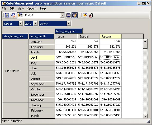

For example I have a lookup cube determining the whether a specific date is Regular working, etc... And I have assumption cube per month to determine the standard rate per month.
I created a staging cube to store the rate to be used depending on the type of day the a specific date it. So my time dimension level is different for the assumption (Months) and lookup(Days).
My Days time dimension has a attribute of its parent.
['Actual Rate' ] =IF(DB('lookup_date_status', !base_day_month, !base_year, 'Status')@='Regular' , DB('assumption_service_hour_rate', 'base_month', !base_version, !base_year, !base_service_type, !plan_hours_rate, 'Regular'),continue);
['Actual Rate' ] =IF(DB('lookup_date_status', !base_day_month, !base_year, 'Status')@='Legal', DB('assumption_service_hour_rate', 'base_month', !base_version, !base_year, !base_service_type, !plan_hours_rate, 'Legal'),continue);
['Actual Rate' ] =IF(DB('lookup_date_status', !base_day_month, !base_year, 'Status')@='Special', DB('assumption_service_hour_rate', 'base_month', !base_version, !base_year, !base_service_type, !plan_hours_rate, 'Special'),continue);
I was thinking of using the ELPAR function for the base_days_month or ATTRS function. I'm not sure where and how to add that additional condition. I tried the code below but its not working
['Actual Rate' ] =IF(DB('lookup_date_status', ELPAR('base_day_month',!base_day_month,!Month), !base_year, 'Status')@='Regular' & DB('assumption_service_hour_rate', 'base_month', !base_version, !base_year, !base_service_type, !plan_hours_rate, 'Regular'),continue);
Time Dimension in Days
Staging cube.JPG (41.9 KiB) Viewed 4273 times

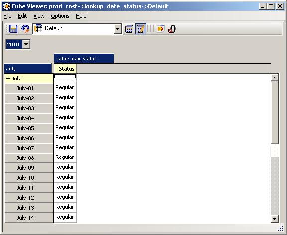

When using ELPAR it reference the parent of the n level element. In your case July 01 will reference July. Thus the ELPAR will return the value for the July consolidator.
In your Lookup Date Status Cube the July Value is empty. Thus returning "".
Try inputting the strings on month level too.
Hope that sorts it.
