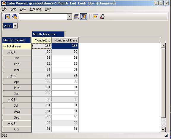

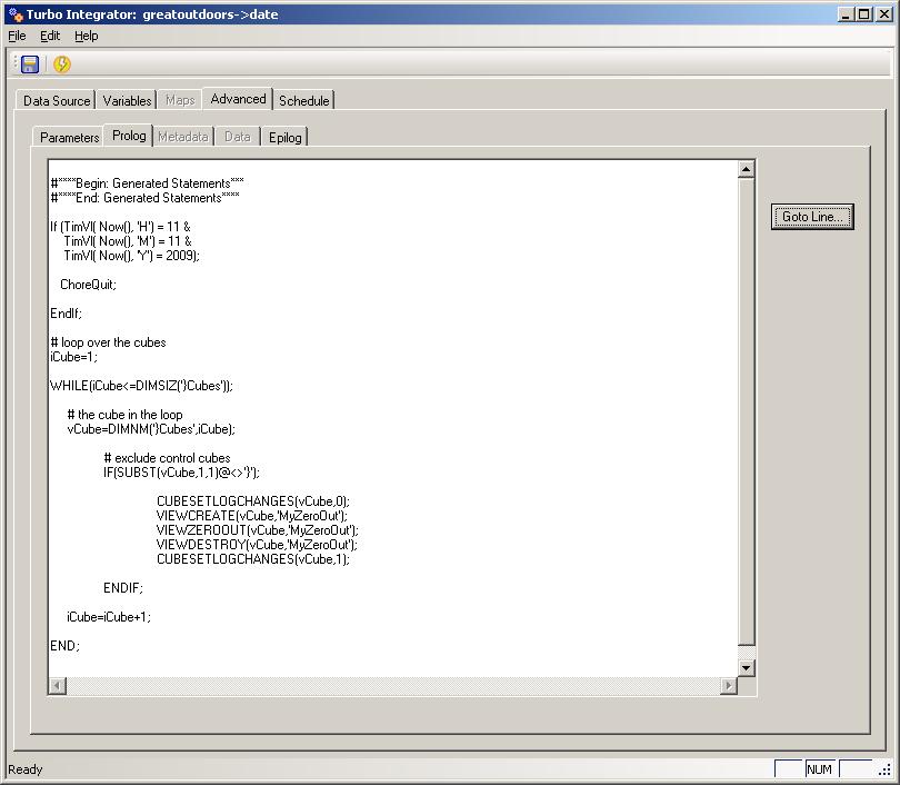

appleglaze28
- Posts: 269
- Excel Version: 2003
Re: Scheduling chores at a specific date
How can make my TI dynamic base on the look up cube since on my look up cube I defined the dimensions for Month & Year.
I assume I would require my Month dimension to need a month number alias to accomodate my needs? How do you reference lookup cubes in TI?
Can anyone help me out with this?
