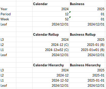

Based on the date provided 31/12/2024, I would expect you to be working with a continuous time dimension, not separate dimensions for year, period etc.
I am then specifically talking about Hierarchies, not Rollups. If you were going to use rollups you would have clashes between periods and weeks.
Calendar Rollups vs Hierarchies.png (12.84 KiB) Viewed 127101 times
Based on the attachment, I am suggesting the bottom approach where the Leaf members exist in all hierarchies but how they are rolled up within that hierarchy depends on whether you are dealing with Calendar or Business.
When it comes to reading data from the cube you would be reading from Period:Calendar:2024-12 for example to view the monthly values for 2024-12 from a calendar perspective. Similarly, if you read from Period:Business:2024-12, the value retrieved would likely differ as it relates to periods rolled up into the Business hierarchy.
