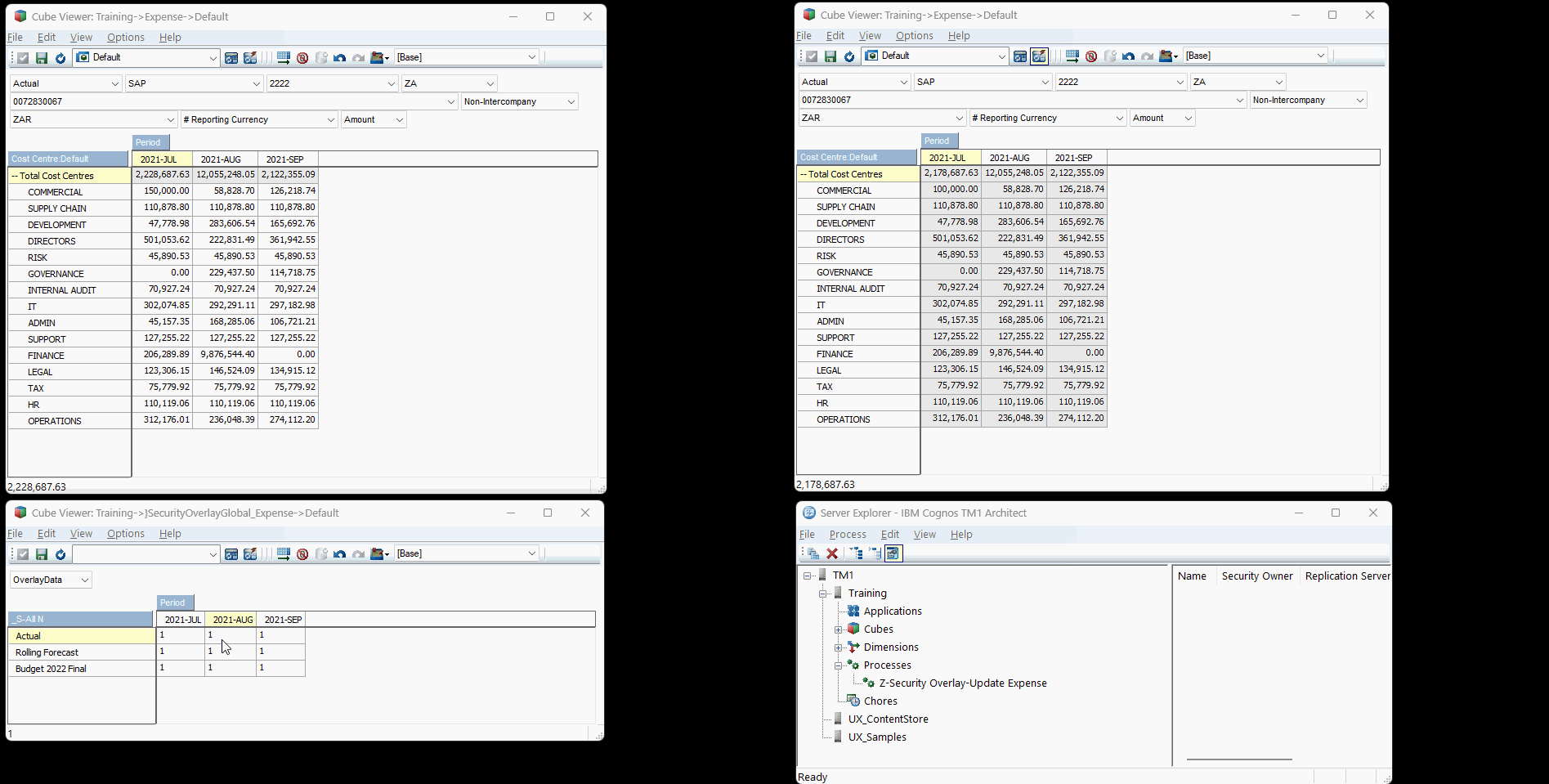

For my 2 cents, it works for me.
The GIF should demonstrate how I use the overlays to block off scenarios e.g. snapshots and periods on the rolling forecast that are not relevant and should not be input. My overlay cube for the demo only has two dimensions: Scenario and Period.
Essentially when I block Actuals and the Period e.g. 2021-JUL, my test user interacting with the objects on the right of the screen cannot update.
On the left is my admin user who has permanent access and can update the overlay cube.
Note too that the process does not run as a full admin as this would allow a write to the cube. Only when I override and use CubeLockOverride, can the test user write to the cube. TI user is thus not always equal to Admin privileges.
Security Overlays.gif (3.42 MiB) Viewed 356938 times

gtonkin wrote: ↑Tue Jun 24, 2025 4:14 pm For my 2 cents, it works for me.
