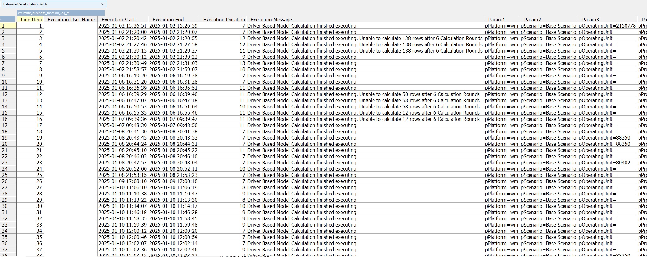

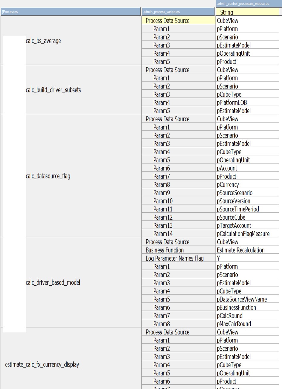

We have a cube where we keep the metadata for all processes. Currently, we populate that cube by scanning all processes, but yes, we can populate it with TM1Py also. But then we reference that cube in every TI Process, and we log the values passed for each parameter, any time the process gets executedWim Gielis wrote: ↑Mon Jan 27, 2025 1:54 pmYou are right but I think that it’s better to focus on the new methods instead of relying on the filesystem. In V12 it’s going to change again with drastic implications.ardi wrote: ↑Mon Jan 27, 2025 1:24 pm You can create a process that scans all *.pro files and *.cho files to extract the information you need. You can extract more information, such as Parameters, their default values etc.
But if your Data Source is dynamic, it will be hard to determine the Data Source of your processes. We keep such information in a cube, including the File Path (in Case of a CSV Data Source), SQL Statement or MDX Statement
- BusinessFunctionLog.jpg (1 MiB) Viewed 42112 times

Looks good ! Do you still have regular data sources to variables etc ? Or is it maybe all text files and the V01… are mapped in the code to good variable names ?
