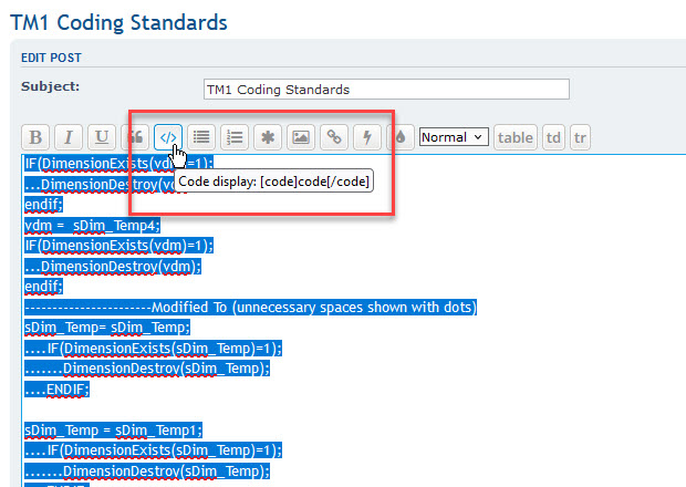

ascheevel wrote: Wed Jan 15, 2025 10:09 pm edit: I see you've added dots to represent spaces, I retract my loathsome statement. Why not put your code in code blocks?
mukeshrajdass wrote: Thu Jan 16, 2025 3:21 am Don't normally use this forum....not sure where i need to do this..
Select your code, then hit the icon that looks like this: [</>] as shown below. It works the same in any phpBB forum like this one, as well as in some applications like Slack. It ensures that the rendered text doesn't ignore spaces, tabs or other indentation code, as well as presenting it in a fixed width font. I've done it for you in this case:
