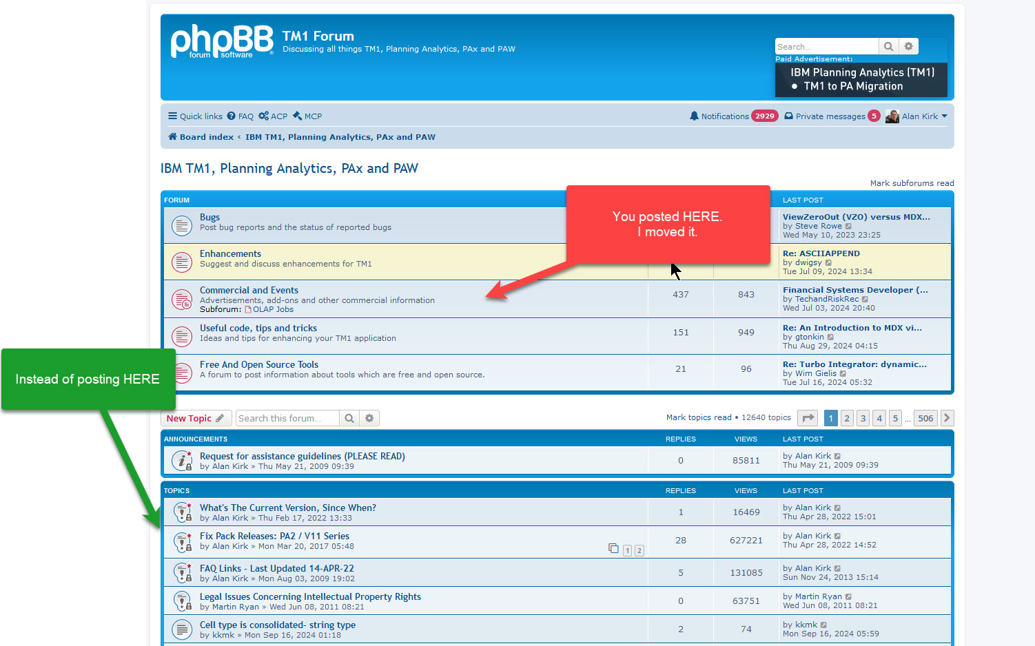

My suggestion would be to post in the regular forum, not with Commercial.

I don’t understand commercial forum and regular forum. Because I post always here. Would you be able to help me with regular forum link please?
Re: Cell type is consolidated- string type
kkmk wrote: ↑Sun Sep 15, 2024 7:59 pm I don’t understand commercial forum and regular forum. Because I post always here. Would you be able to help me with regular forum link please?
Basically, THIS:
