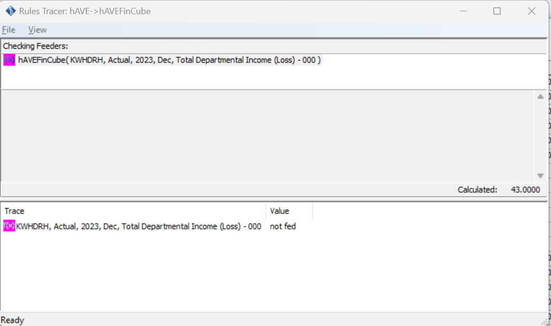

This is all within an account dimension. I'm having an issue where Total Departmental Income (Loss) is not being fed, and thus Total Hotel GOP is not being fed when Total Revenue - 000 is zero but Total Departmental Expenses - 000 is not zero.

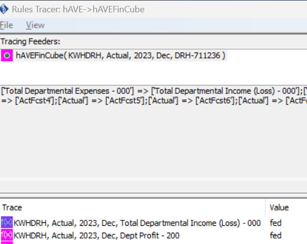

Trying to trace why this is not working, I check feeders on Total Departmental Income (Loss) - 000 and it says that the cell is not fed. But when I trace feeders on a singular leaf cell part of the consolidation Total Departmental Expenses - 000 it says that Total Departmental Income (Loss) IS FED as is Total Hotel GOP. Why would check and trace feeders disagree about the exact same cell intersection being fed?

I think I answered my own question here. Seems in line with viewtopic.php?t=311
I speculate that "Trace Feeders" shows what "should be" fed based on the setup vs. "check feeders" shows what IS fed based on the last time the feeders fired.

Re: Trace Feeder and Check Feeder Disagree
Yes, also correct, Trace shows what would happen now if the feeder statement fired and Check shows what did happen.
