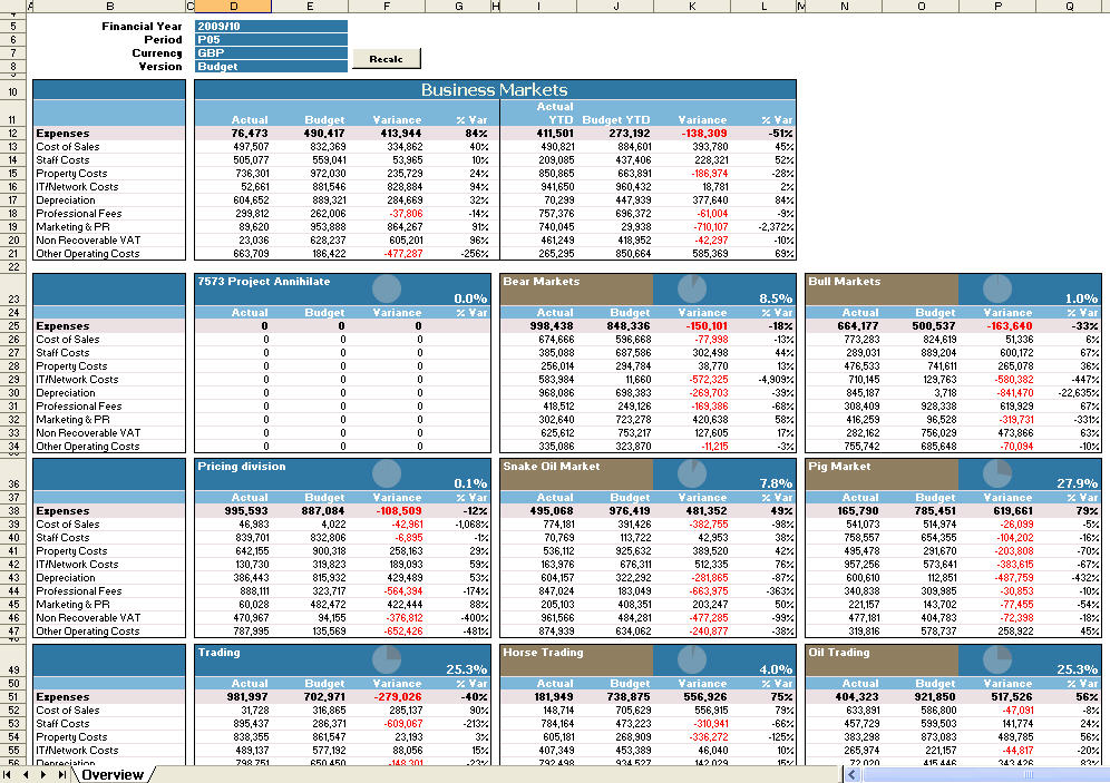

I have a dynamic subset which filters the elements (Centre) by attributes (attribute IsCentreClosed <> Y).
What I want to do is, in a report enable a user to select a centre from the dimension using the filtered subset, and then display the children of that centre (if the centre is a consol) using the filtered subset.
In the image below, there's a SUBNM attached to where it displays "Business Markets" (Cell D10), and the rest of the report is driven by ELCOMPs.
(numbers randomized and centre names changed)
However, since ELCOMP is based on the Dimension and not the Subset, centre "7573 Project Annihilate" which is closed appears on the report.

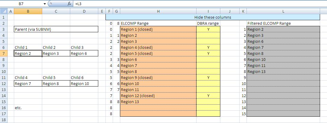

Hi Kaveenga (and Paul)
Not that your approaches aren't valid or won't work but this is quite a simple problem and these solutions are seriously overcomplicated for the problem at hand!
Don't forget that in this case your reporting interface is Excel which has a vast arsenal of tools which can be applied to the task of metadata validation. Why go with a "pure TM1" approach when you have Excel at your disposal? Attached is a very simple spreadsheet which solves Kaveenga's issue and uses nothing more than ELCOMP, DBRA and a VLOOKUP.
This took less than 5 minutes.
SimpleListFilter.xls
(22 KiB) Downloaded 634 times

Thanks Paul and lotsaram.
I modified the custom ELCOMPSUB function to make it more efficient. However, since our centre hierarchy is quite deep it took a while when drilling up into higher level consolidated elements - eg. if I drilled up into All Centres, it took about 2 mins to calculate the immediate children of All Centre wrt to the subset. However, anything lower than All Centres took about 20 secs.
So now I moved to a spreadsheet based method of finding the immediate parent and immediate children of an element wrt to the selected subset.
The report works brilliantly and very fast now. Will post my final report and method soon.
