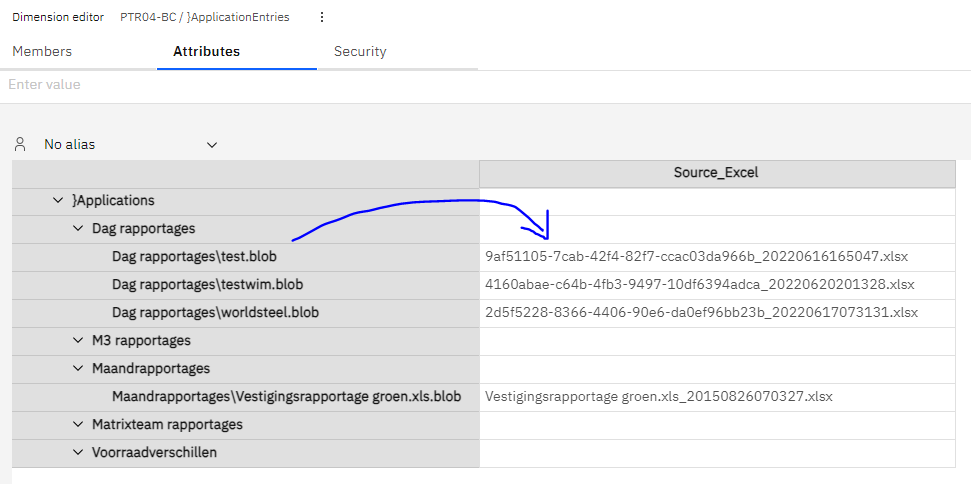

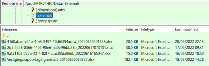

In this post I wanted to take you through a custom and generic Turbo Integrator process related to the management of Excel files and blobs in TM1. When authoring Excel files in IBM Planning Analytics for Excel (PAfE) or IBM TM1 Perspectives, you could upload the files to the TM1 Content Store. Subsequently, these files can be used in IBM Planning Analytics Workspace (PAW) or IBM PASS (Spreadsheet services, TM1 Web). Excel files do not need to be uploaded of course, you could use them standalone. Uploaded files will be physically stored in the }Externals subfolder of the TM1 Data directory. A related blob file is created in the }Applications subfolder of the TM1 Data directory, mimicking the navigation of Application entries in TM1. The TM1 dimension '}ApplicationEntries' maintains these structures.
When working on a recent Move to cloud, I noticed a whole lot of files in the }Externals subfolder of the TM1 Data directory of the customer. Also, thousands of application entries. I was pretty sure that a good number of files would have become orphaned and obsolete by now, given the 10+ years of life of the TM1 model. But how do you know what Excel files are referenced and what files are not ? You could interrogate the *.blob files with Notepad++ or similar (a programming language like Python or PowerShell for instance) but it's not very obvious. Given the existence of the up to date dimension }ApplicationEntries, I prefer to come up with a decent generic TI process. It will be part of a larger TM1 library of custom processes that I can easily tap into when needed.
The attached TI process is the result of my automation. Basically:
- I loop over all the blob }ApplicationEntries in TM1
- I then recursively call the same process and open the blob file as a text file to compile the needed information: the blob text file contains the reference to the used Excel source file
- I update a text attribute to store that link
- In the Epilog of the main process, after all the information is gathered, I wrote code to delete the source Excel files that are NOT referenced in the blob files
