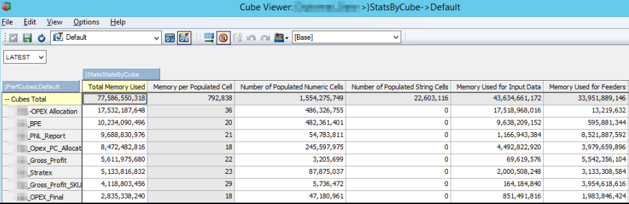

Have you looked at what usage the cubes show using Performance Monitor and }StatsbyCube? Add a new numeric member called: Memory per Populated Cell and then the rule below.
I then sort my cubes from highest to lowest on Total Memory Used and then look at the value in the Memory per Populated Cell.
Typically anything over 40 may be a concern but there are many factors that can increase the value so some consideration needs to be given to the following:
['Memory per Populated Cell']=N:
['Memory Used for Input Data'] \
( ['Number of Populated Numeric Cells'] +
['Number of Populated String Cells'] );Typically anything over 40 may be a concern but there are many factors that can increase the value so some consideration needs to be given to the following:
