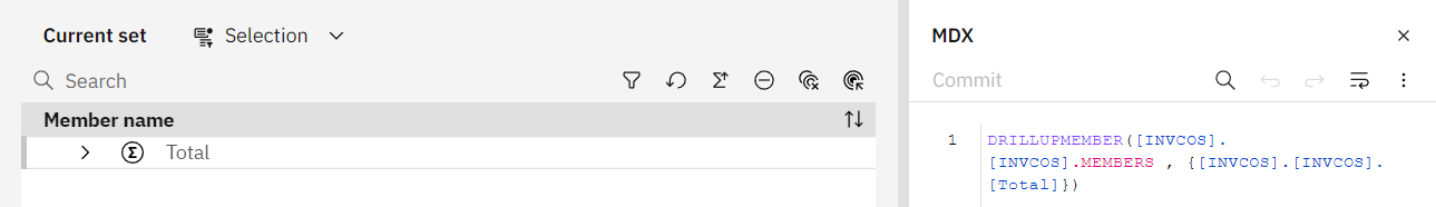

The dimension editor in PAW Workbench will always show the result of the MDX expression [<dimension>].[<hierarchy>].members which will show every consolidation fully expanded resulting in elements being represented twice when they are children of multiple consolidations. Since an element can only have one index, this view can never be a true indicator of an element's index.

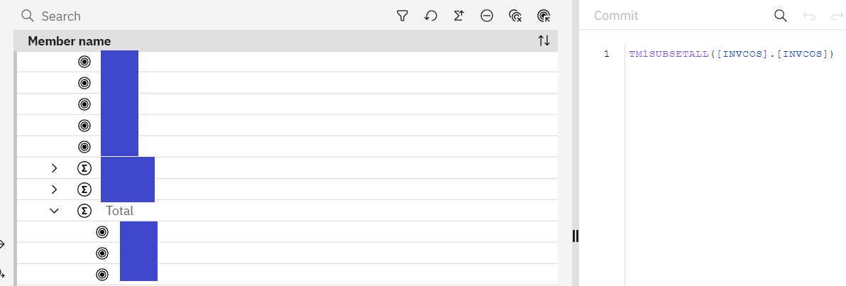

For the set editor in PAW and PAX, the initial All Members view on the right side is the result of the same mdx expression as the dimension editor: [<dimension>].[<hierarchy>].members. If you want to see the exact same order here as when you hit the "SubsetAll" button in the Architect subset editor (all elements ordered by index) you can replace the MDX in the PAW or PAX set editor with this TM1SubsetAll([<dimension].[<hierarchy>]).

I do see now in PAW where I can modify the MDX in the subset editor. Is there a way I can modify the ordering returned by TM1SUBSETALL?
What is more confusing is that in the Dimension Editor (or MDX .Members return), all of the N level elements roll to the top level consolidation, but when I use TM1SUBSETALL MDX, some elements that are shown in the consolidation, are no longer shown under the consolidation (collapse consolidation, and elements are still showing etc.)

WilliamSmith wrote: ↑Thu Feb 22, 2024 2:04 pm I do see now in PAW where I can modify the MDX in the subset editor. Is there a way I can modify the ordering returned by TM1SUBSETALL?
No, TM1SubsetAll takes only one argument: [<dim>].[<hierarchy>]. You would need to apply other MDX functions to the result of TM1SubsetAll to get desired results.
WilliamSmith wrote: ↑Thu Feb 22, 2024 2:04 pm What is more confusing is that in the Dimension Editor (or MDX .Members return), all of the N level elements roll to the top level consolidation, but when I use TM1SUBSETALL MDX, some elements that are shown in the consolidation, are no longer shown under the consolidation (collapse consolidation, and elements are still showing etc.)
What's the element and component sort type setting for the dimension? My guess is it's still ByInput so when you apply TM1SubsetAll, you're not getting a hierarchy sorted result as the elements are sorted by index. If you apply ByHierarchy to the ElSorttype, do TM1SubsetAll again, and then collapse Total, you won't see any elements visible outside of Total anymore.
