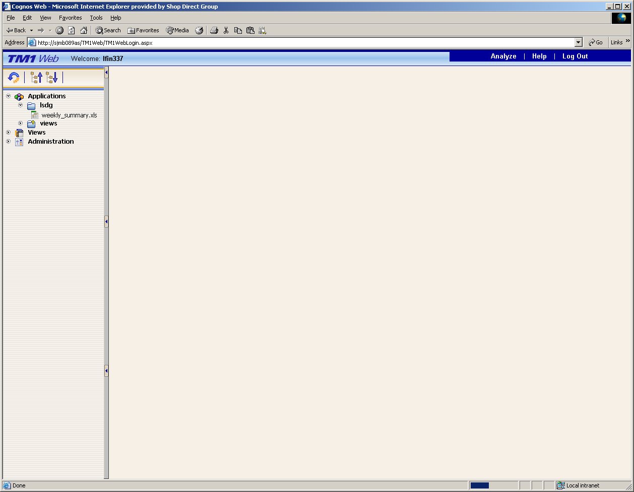

You could help ease that guilt by telling me why no excel sheets seem to publish? I have checked that the TM1 Excel is running and it is, yet no sheets (no matter how simple) will work. It tries to open the web page and just stalls,
Jim.
Re: TM1Web Issue
Posted: Wed Oct 28, 2009 11:06 am
by Alan Kirk
jim wood wrote: You could help ease that guilt by telling me why no excel sheets seem to publish? I have checked that the TM1 Excel is running and it is, yet no sheets (no matter how simple) will work. It tries to open the web page and just stalls,
That sounds familiar but I can't quite put my finger on it at the moment. I'll have to take a look at it in the morning when I have access to the Web server. In the meantime, what method are you using to add the websheets to the Applications folder? Are you doing it via Server Explorer or via Excel? If it's the former, what are the settings that you're using in the dialog?

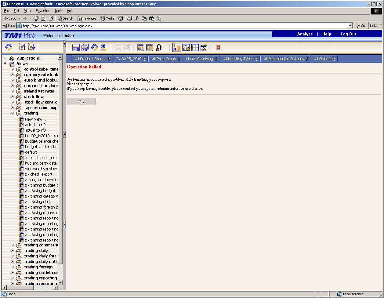

I don't know if this is a seperate issue but the charting option doesn't work either,
Jim.
Re: TM1Web Issue
Posted: Wed Oct 28, 2009 2:53 pm
by jim wood
A couple of images to help
Chart Issue
Chart Issue
Screen Stay Blank When Trying to Open Excel Report

We have normally seen this error if there is a permission problem on the directories that Web is using to store the temp files it is trying to display. Without having access to my server there is the ExcelSheet directory and I believe one other. Applix\cognos\IBM's answer was to give everyone access to the specific directories. There is a tm1web log file that can sometimes provide more information on where the specific error is occurring. I will be happy to look up the specific directories when I get back to the office in the morning if you have not been able to solve it.
Re: TM1Web Issue
Posted: Thu Oct 29, 2009 3:09 am
by Alan Kirk
George Regateiro wrote: We have normally seen this error if there is a permission problem on the directories that Web is using to store the temp files it is trying to display. Without having access to my server there is the ExcelSheet directory and I believe one other. Applix\cognos\IBM's answer was to give everyone access to the specific directories. There is a tm1web log file that can sometimes provide more information on where the specific error is occurring. I will be happy to look up the specific directories when I get back to the office in the morning if you have not been able to solve it.
Good thinkin' George. The folders concerned are under C:\Inetpub\wwwroot\TM1Web, specifically ExcelSheet and TempCharts. There's a good outline of the permissions that need to be assigned (particularly for the Guest account, which is critical) on page 6-26 et seq of the 9.0 TM1 Web guide. (6-71 of the Operations guide if Jim's using the 9.1 manuals.) Screen shots and everything.
