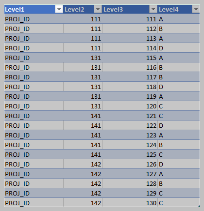

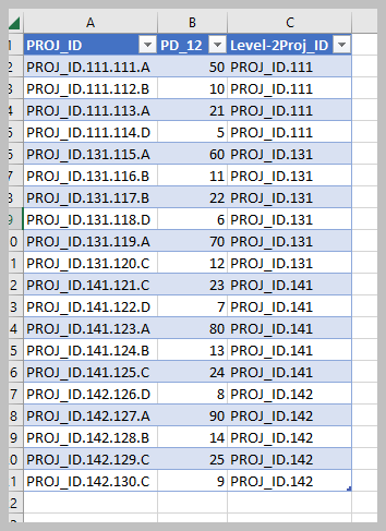

I have a requirement to develop a perspectives report. The report has a complexity to report at a lower level depending on the last level (char) of the Project. I will attach sample data.
Like you see in the full data sheet, all projects end with an alpha char which implies to what expense type it is.
All Ending With A - Uniform
All Ending With B - Supplies
All Ending With C - Chemicals
All Ending With D - Spare Parts

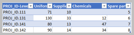

Using the full data, we want to report at level 2 of the project - what is shown in second pic.
Can someone please help with the logic on getting the report built? Any direction will be helpful.

Yes, Project dimension hierarchy is in place and attached the image. can you give me a hint on getting the data at level 2?

Depending on the level 4 of the project, we report at level 2.
Paul.

An example output would be useful too ?

Thanks Wim, I created another cube and a dimension (for level 4 for proj dim - idea from you) and it works like a charm.
Could we go without a cube? maybe we could, but in a cube form, it data looks good for verification.
