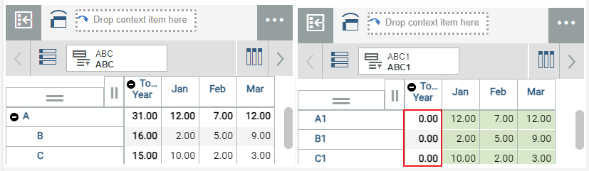

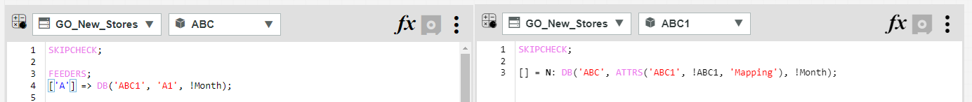

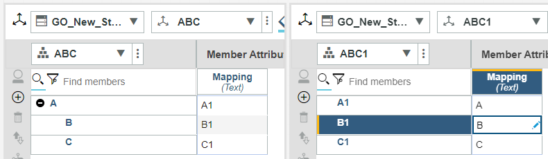

Question #1:
Cubes, attributes, rules and dimensions are on the screenshots. What will Total Year value be for each ABC1 element after feeder rule is saved?

Only B1 and C1 are being fed, so the in the ABC1 Cube, the value of each elements will be:
ABC1('A1', 'Total Year') = 0 # A1 is not being fed,
ABC1('B1', 'Total Year') = 16
ABC1('C1', 'Total Year') = 15
Re: Ultimate Long TM1 quiz
Posted: Mon Jan 08, 2024 2:49 pm
by ZLD
Same as above 0, 16, 15.
A is not fed since feeders only apply to leaf cells not consolidated ones, B and C are fed instead to B1 and C1 in this case because feeding from consolidation will feed its leaf descendants, thus B1 and C1 cells are marked to use standard dense data structures algorithm.
SKIPCHECK is in rules of the fed cube, so sparse data compression algorithm is on by default. When calculating consolidated cells of "Total Year", A1 cells are not marked as exception to the algorithm so they will be skipped while B1 and C1 are, so ['A1', 'Total Year'] is 0, ['B1', 'Total Year'] 16, and ['C1', 'Total Year'] 15.
Posted: Mon Jan 08, 2024 11:33 pm
by WilliamSmith
ABC1 intersection @ (Total Year, A1) is not being fed, so the value will return 0.
B1 will consolidate across month dimension = 16
C1 same = 15

Correct answer: 0 16 15.
Winner of this week is ardi!
All answers are correct, but ardi was first.

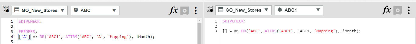

Question #2:
Same rule, Feeder is changed:

Still the results will be the same:
  • A1 will not be fed
    B1 will be fed from B
    C1 will be fed from C

-Correct answer: 0 16 15. Again
Again :).
As a reminder: the best answer is correct, most detailed and most independent one. Nobody has described how feeders work when consolidated element is set on the left side of feeder and why numbers have not changed. If there was such description, I would give prize to it's author.

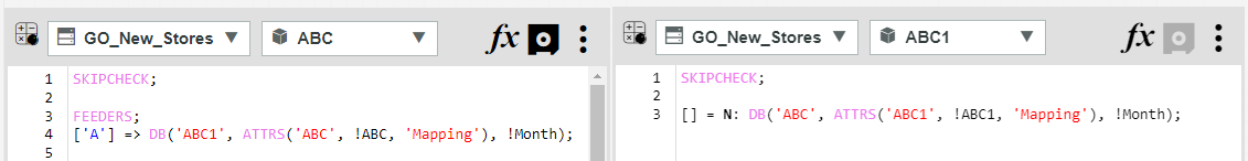

Question #3:
Same rule, Feeder is changed. There is a tricky part in this question, be careful!

We're assuming persistent feeders are off and cube is unloaded/reloaded after each feeder change right?
ABC1('A1', 'Total Year') = 31 (fed from ABC:B & ABC:C)
ABC1('B1', 'Total Year') = 0 (not fed)
ABC1('C1', 'Total Year') = 0 (not fed)
ABC:A is consolidation so leaf children of A will feed ABC1:A1
ABC:B feeds ABC1:A1
ABC:C feeds ABC1:A1
Posted: Sat Jan 20, 2024 1:42 pm
by Elessar
No additional actions were announced ;) Just changed the feeder and saved the rule
Posted: Sat Jan 20, 2024 2:29 pm
by ardi
In that case, all cells will ne fed. Previously fed cells will remain fed until feeders will be rebuilt. On top of existing feeders, the updated feeder will Feed A1, so the results will be:
But after the feeders get rebuilt, B1 and C1 will not be fed anymore

Then I concur with ardi, ABC1:B1 and ABC1:C1 retain their fed status from previous feeder. If model is configured with persistent feeders ON, this will persist even after a server restart. If persistent feeders is OFF, then ABC1:B1 and ABC1:C1 will no longer be fed after the next cube unload/load or server restart.

Correct answer:
  • 31 16 15 - if rule was just resaved;
  • 31 0 0 - if rule was written from scratch.
If a cell is fed once, it will retain being fed even if we delete the whole "FEEDERS;" section. Server will not run through the whole cube looking for fed cells.

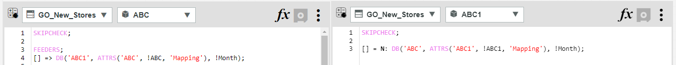

Question #5:
OK, I've saved a new feeder and restarted server (to be completely sure :)). Same rule, same question: What will Total Year value be for each ABC1 element after feeder rule is saved?

ABC1
A1: 31
B1: 0
C1: 0
From cube ABC, leaf children of consolidated element A will feed the mapping attribute of A since you hard coded the element reference in the ATTRS statement. Feeder has same effect as your feeder in Question #3 only this time you've cleared all prior feeders.
From ABC
B will feed A1 (mapping attribute for ABC:A)
C will feed A1 (mapping attribute for ABC:A)
