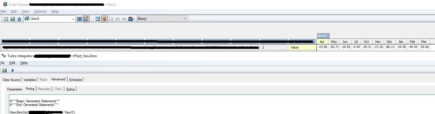

EP_explorer
Posts: 221
OLAP Product: PAL
Version: 2.0.9
Re: ViewZeroOut doesn't work
Post by EP_explorer »

EP_explorer
Posts: 221
OLAP Product: PAL
Version: 2.0.9
burnstripe wrote: ↑Sat Dec 09, 2023 10:38 am What version is this on
https://www.ibm.com/support/pages/flash ... hout-error
It seems you are right
Version is 9.0.4
Thank you
