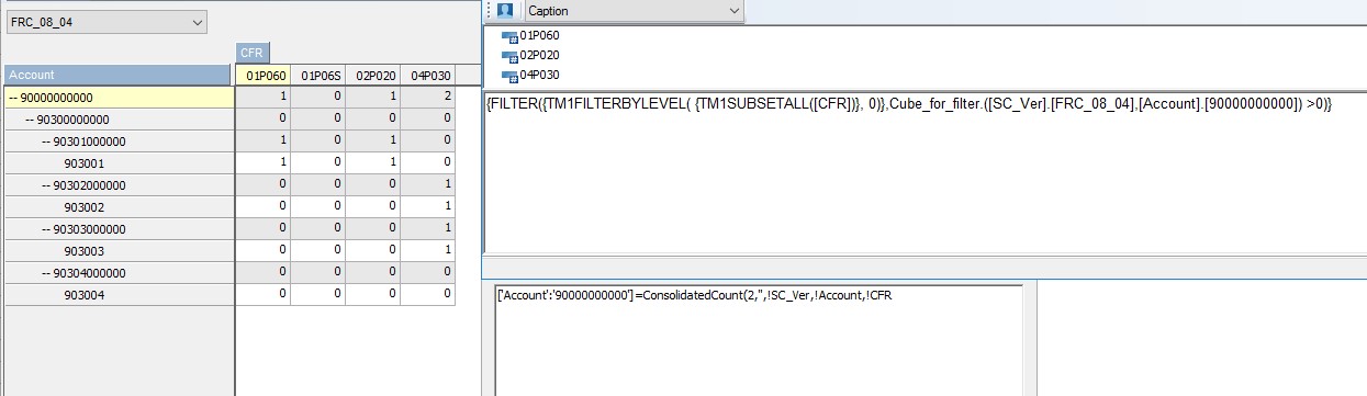

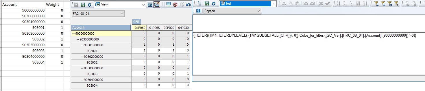

So I have a dimension with zeroweight elements (left on picture). Cube in which I have flags (in the middle) and MDX which have to filter CFR dimension based on Sum element (90000000000). As 90000000000 contains 0 so filter return nothing (right)
After it I add in Cube Rule whcih calculate 90000000000 using ConsolidatedCount. And filter starts working (actully I made mistake early) but I found another problem - on real volumes it works slowly than simple consolidation.
I think of create new dimension which contains only 90000000000 and details elements (based on Account dimension). It works faster but less convinient (I have to mantain 2 dimension - Account with zero weightd elements and new - Account_details).
May be anybody have another ideas?
