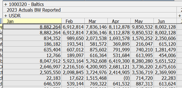

TM1 should display values in /1000 format.
Hello Everyone,
I need some help related to data formatting.
We re loading the data values form SQL, and data load is working as excepted.
Now user wants to see the values in TM1 in /1000 format.
Ex - of the cube view data is displaying as 4,880,505 - user wants to see value as /1000.
4880505 /1000 = 4881

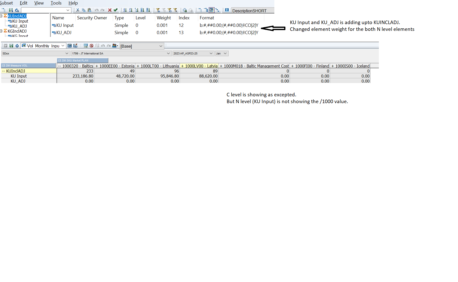

Jlekkala
- Posts: 5
- Joined: Mon Jul 03, 2023 8:50 am
- OLAP Product: IBM TM1
- Version: 2.0.9.15
- Excel Version: Version 2208 Build 1
Re: TM1 should display values in /1000 format.
I have one doubt,
is there any chance it applies to N level also.
As of now its applying only for C level element.
Please suggest
Please suggest
Yes, /1000 fromat is applied to C level element
but for N level, its not showing /1000 value.
Please suggest
Please suggest
- 1000fromat_Nelement.png (73.93 KiB) Viewed 4325 times
How can the n level show the value /1000 ?
It is the big value that is divided by 1000 and shown on the C level. The n level is unchanged.
Got it Wim.
Thank you for support.
