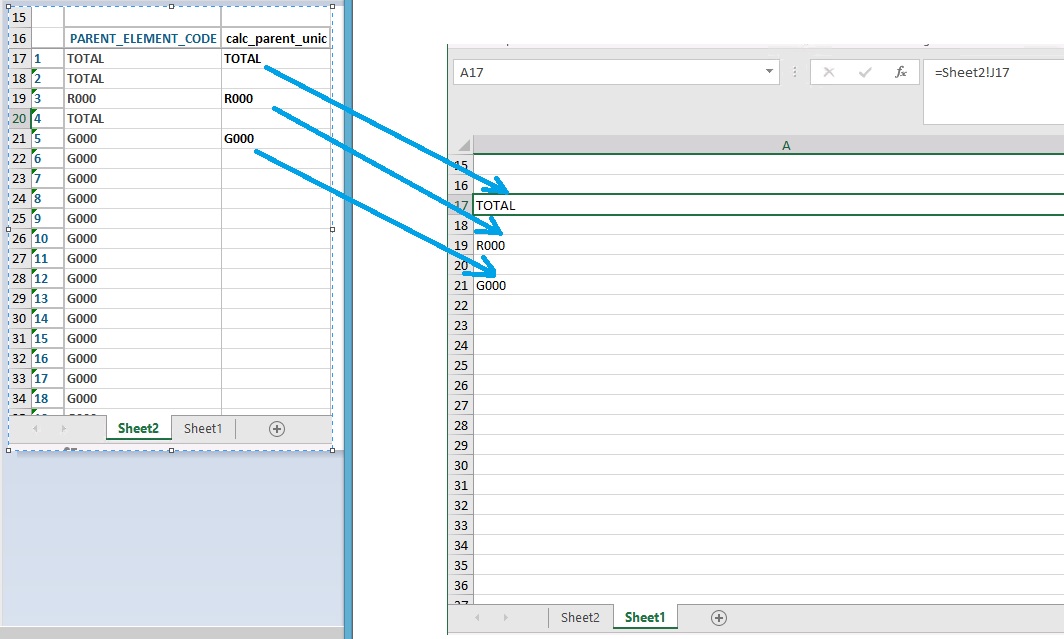

I'm trying to make some calculation in Excel based on data from Dynamic Report (which using MDX filtering in it)
So at first step
I open Dynamic Report (Active Form) which shows data on Sheet2 and make simple link from column J to Sheet1 column A
It seems works

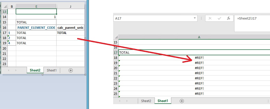

After it I make filtering in Dynamic Report (show rows only which contain TOTAL). Only 3 rows
And the most part of my links on Sheet1 shows like #REF (and next calculations based on column A are imposible)
So may be you know how avoid such sort of behavior

On dynamic reports the data rows are destroyed upon rebuild, so any direct reference to these rows will be destroyed on rebuild. Hence the links are broken as you are experiencing.
One workaround would be to use the offset function were the range start is above the dynamic rows, then when the report rebuilds the link is intact because the formulae doesn't refer to any cells in the dynamic report directly

You can try using Indirect() and passing in the cell reference as a string.

I'm creating some sort of filter for rows
I find unic elements in column PARENT_ELEMENT_CODE
and put them in list (sort of combobox)
After I choose one of elements I see only rows which contains TOTAL in Column PARENT_ELEMENT_CODE
