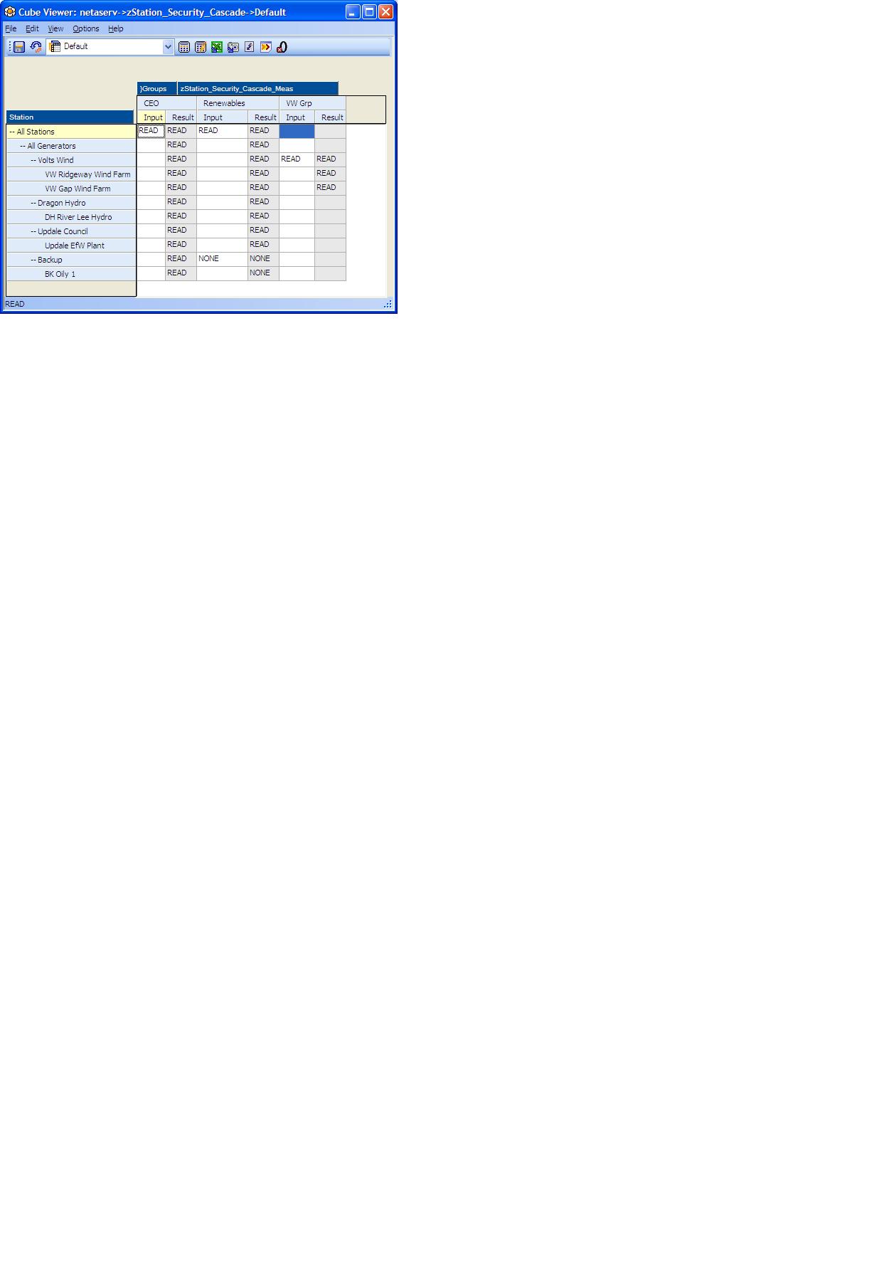

For the cascading security you may like to try the following alternative.
My example uses Electricity Generating Stations, rather than Clothing Products, but the key thing is that a hierarchy is involved.
Create a cube called zStations_Security_Cascade with dimensions
Station
}Groups (You can use } control dims in normal cubes)
zStations_Security_Cascade_Meas
which has two string elements:
Input
Result
Create a Rule and add the following:
skipcheck ;
['Result']=S:
IF( DB('zStation_Security_Cascade',!Station,!}Groups,'Input') @<> ''
elpar('Station',!Station,1),
!}Groups,
'Result'
This is a recursive rule, which cascades any value entered in to the Input measure down to all elements below it, until interrupted by another Input Measure. See the attached example.
Set the security on this cube so that only Admins & Security Admins can see it.
Then in the }ElementSecurity_Station cube you just need to add the following rule:
skipcheck ;
[]=S:DB('zStation_Security_Cascade',!Station,!}Groups,'Result');
This pulls the Results of the cascaded security across, to the security cube where it has the desired effect.
The only thing that you need to remember is that TM1 can be a little finicky around Rules in security cubes, and you may need to run a TI process with the SecurityRefresh function to get TM1 to acknowledge changes in security. However, I generally find that this isn't necessary. In the worst case, it is only needed when you actually change the security. I would be interested to hear how it performs on a 13000 element dimension. The dimension where I am contracting has around a 1000 elements.
Things do get a little more complex if you have alternate hierarchies in your dimension, ie if an element can have more than one parent. However, I have successfully extended the above approach to cope with dimensions that have 6 altenate parents for some elements.
Paul Simon
Input
Result
skipcheck ;
['Result']=S:
!}Groups,
'Result'
skipcheck ;
Paul Simon
- Cascading Security Example
- SecurityCascade.JPG (83.79 KiB) Viewed 24185 times
